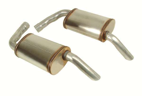

I am looking at the Magnaflow 323066 which is a 1pc hideaway muffler that could possibly bolt right on although I will probably have to cut my existing exhaust because the inlet pipe on my old round mufflers isn't nearly as long as the Magnaflows. I am also thinking about a set of Flowmaster 40's and just build my own pipe to connect to my existing exhaust and add chrome turned down tailpipes to them.
Old Jun 8, 2015 | 01:45 PM
BKarol's Avatar
BKarol
Joined: Sep 2004
Posts: 3,220
Likes: 665
From: Northeast
This is what the #323066 hideaway looks like from the side however I purchased the complete true dual exhaust system kit from CC for my 78 L82 so the pipes they provided matched up to the mufflers. The problem for you will be getting the mufflers onto your pipes.:
I cut the tips and added some short chrome extension & do like the hideaway feature:

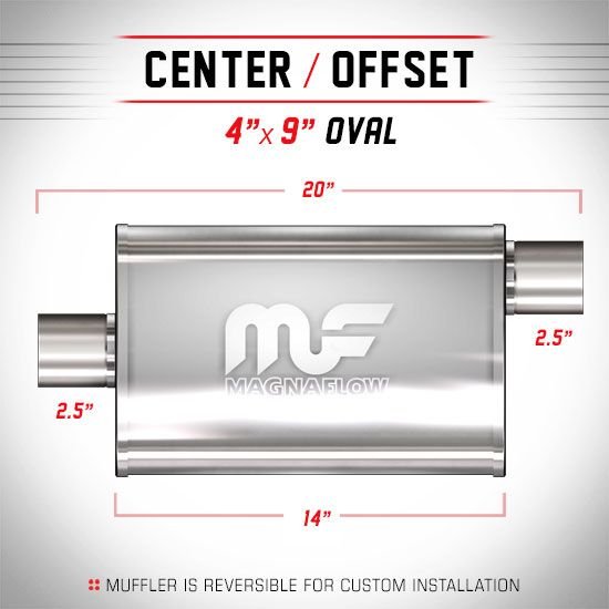

Old Jun 18, 2015 | 09:08 PM
  #40
Magna_Flow's Avatar
0Magna_Flow
Former Vendor
Joined: Jan 2015
Posts: 412
Likes: 64
Originally Posted by Magna_Flow
The dimensions aren't in the catalog or product description for the cat-back, but I'm checking to get a part number if they're one of our universal mufflers.
Mufflers are 4" x 9" x 14" ovals with 2.5" in/out and an offset shape.
Part numbers are 11226 (Stainless finish) or 14326 (Polished finish).
