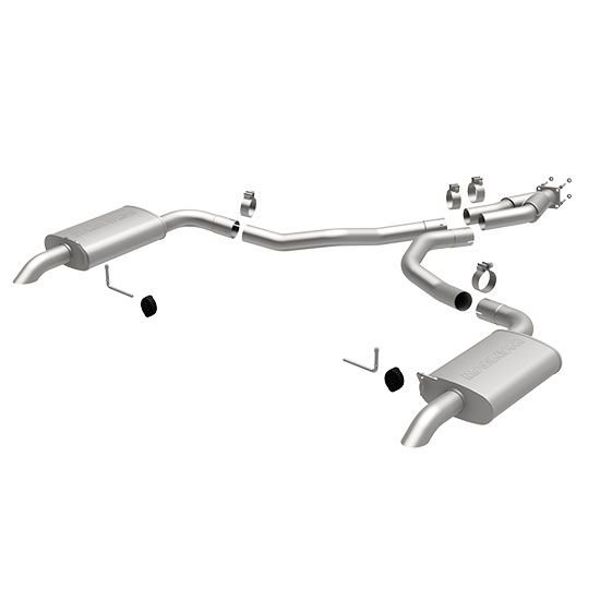

Old Jun 1, 2015 | 10:17 PM
Magna_Flow's Avatar
0Magna_Flow
Former Vendor
Joined: Jan 2015
Posts: 412
Likes: 64
Originally Posted by jgcable
That's exactly what I am looking for. Do you have the model number of those mufflers? I want to see if they are a direct bolt on when I remove the large round ones.
For the 1975-1979, we sell it as part # 16710, which is a cat-back.
For earlier C3s, we have a few more exhaust system options, but if we don't list them for the '75-'79, then they aren't a direct-fit for those years. Let me know if you have any questions about that.
Old Jun 3, 2015 | 11:23 AM
jgcable's Avatar
jgcable
Joined: May 2015
Posts: 569
Likes: 20
From: Milford, CT
What I want to do is just replace the mufflers. The entire dual exhaust is new. I want to take off the horrible gigantic round mufflers and replace them with something low profile with a nice throaty sound. The mufflers themselves in your diagram look perfect. I just need to measure the OD of the pipes I have once I get the mufflers off. Do you sell only the mufflers and if so.. is there a way I can get the dimensions of them so that I can make sure they will bolt on with no modifications?
