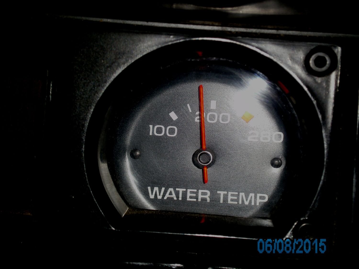

Took a drive in the '77 vette to town today to drop off the wife's car for alignment. when I got home I popped the hood and snapped a picture of the cap temp and then a pic of the temp indicator inside the car. Both indicate 180*. This is immediately after pulling into the garage and the cooling fans had just shut off. Looks like the cap temp gauge is pretty accurate.
