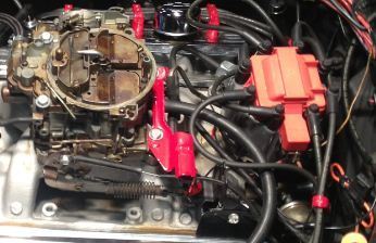

Need to make sure the dizzy hold down is tight. Put the light back on it and turn dizzy until mark lines up at 10 -12 degrees BTDC with advance disconnected and plugged, engine idiling and at operating temp if dizzy was loose. I would reset timing even if dizzy not loose just to be sure the timing is correct.

this is my distributer - honestly haven't begun to learn about it yet (as in not sure how to adjust it yet!
