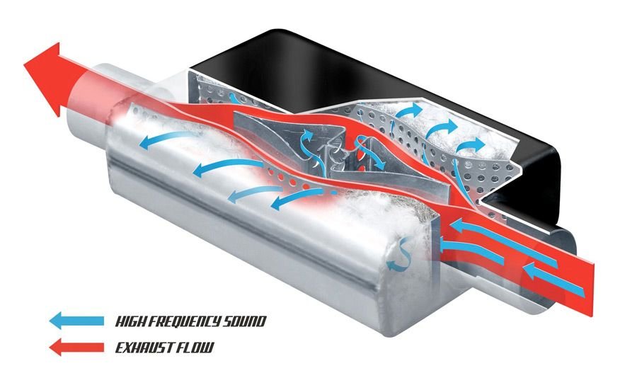

Ultra Flows don't have any baffling - they are straight through & use CRF packing material - they are the BEST flowing mufflers on the market. They do not "tune" the exhaust note any - Magnaflows are knockoffs of the Ultra Flows & sound essentially the same. If you want some sort of baffled Dynomax muffler, you'll have to go to the Super Turbo line - they are an excellent performing & sounding turbo muffler. They have a 3-tube internal design with flow directors, & the center chamber is wrapped with a fiberglass blanket. The blanket will however break down over time & they will get louder. If you want to take a look at a pretty cool design "box" muffler, check out the Cherry Bomb Vortex (above). Excellent flow & I've heard them & I think they sound great. Very similar to an internal design I designed a 15 years ago.
