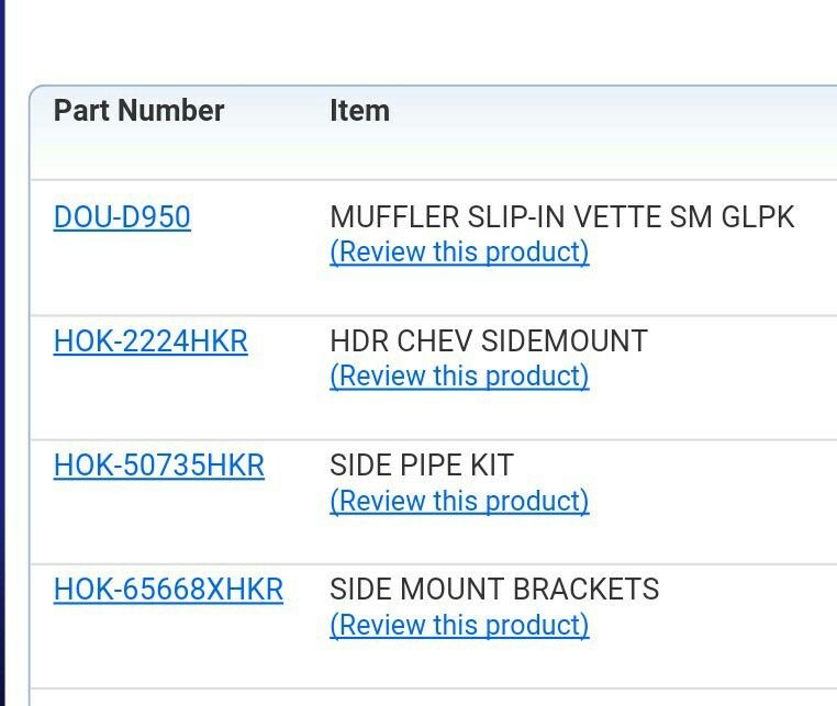

I just got these delivered today for my 1977 from Summit.
I went with black, too.
