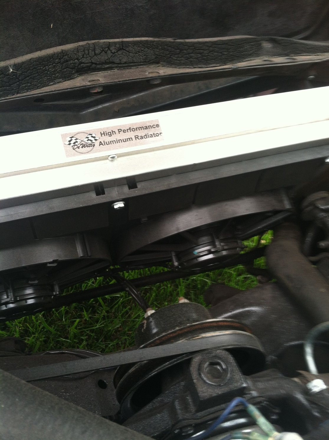

I will take some pictures of the fans and the engine. See i did drive it and the temp was good. The oil is dirty looking but no water in it. Also i had this local shop but in the engine and the radiator and electric fans.

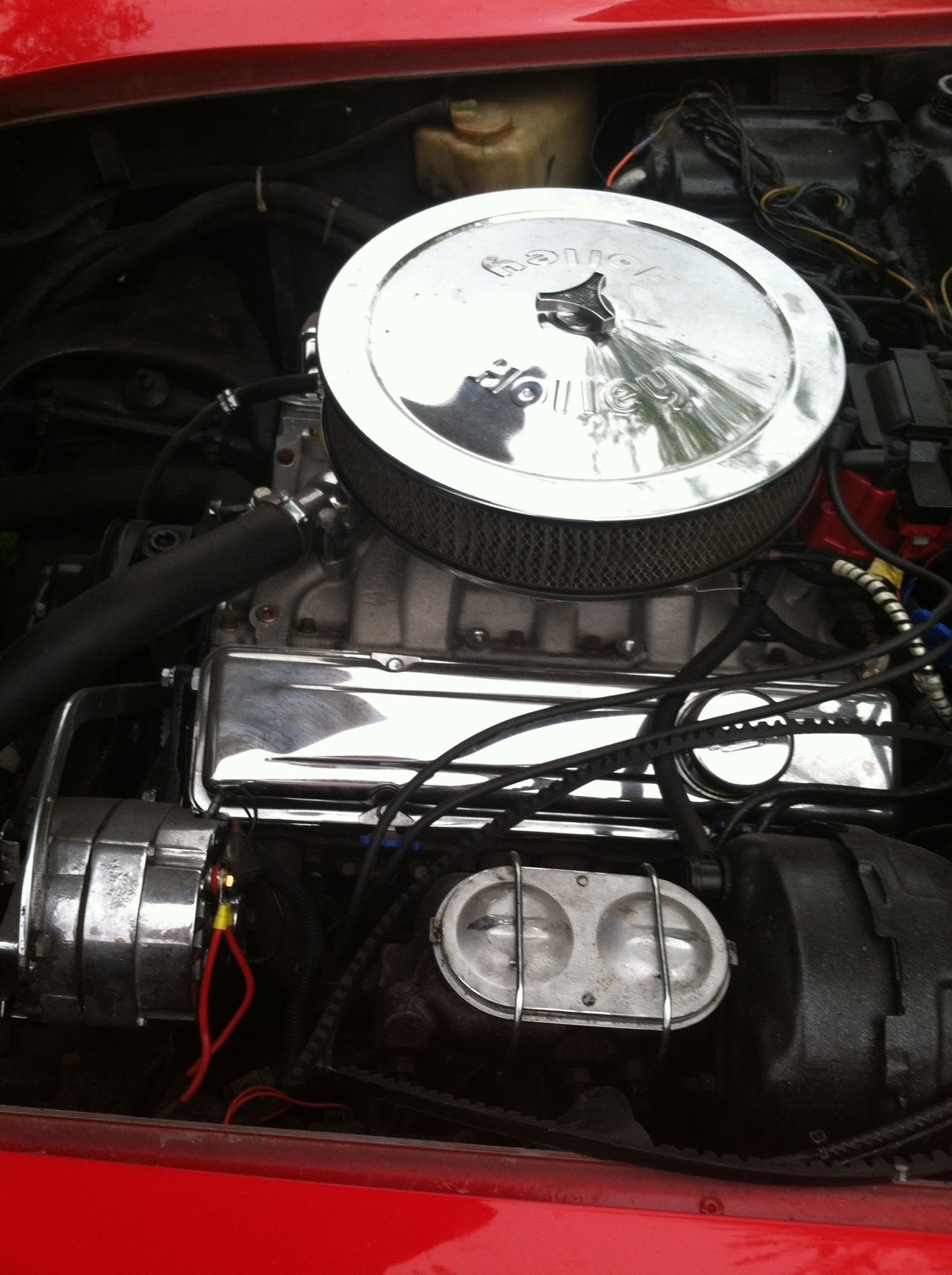

Here are some Pictures

You had a freeze plug fall out, for some reason.
That's why it overheated, and seized up. The only mistake I see by your son is he apparently continued to drive it during this failure.
I threw a fan belt on my engine. It overheated extremely fast, but I had no place to safely pull over immediatly. I drove it about 5-7 minutes with steam pouring out the radiator overflow tube before I shut it off. After installing a new belt and filling up the radiator, all is well, and I've driven it a couple of thousand miles. However, it did start leaking oil at the rear main seal. I've since installed a serpentine belt system to avoid the the thrown belt issue.
I too have a Dewitt's and electric fans. The thrown belt was turning the water pump.

It looks like you have a belt from the water pump to the alternator. I see another belt laying around the brake booster, and it looks broken. What is that for?
The belt laying on the engine looks like it went around your waterpump and crank. The belt still on it now only goes around your alt and water pump. Sooo, looks like nothing was turning the water pump and your engine overheated blowing out the freeze plugs and locking it up. You did not notice the belt laying there before you started this post ?
Again as already said, something broke and since your son did not notice the steam and the temp gauge, it only got worse.

Something broke, engine seized. Be lucky that broken belt didn't go and hit that fuel line that is way to far forward or your problems could have been worse. IMO.
