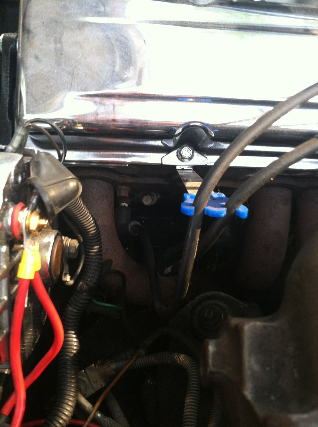

Originally Posted by bashcraft
Looks like a broken temperature sensor.
Yep, the electric ends are broken off.
There should also be a temp sensor boss on the passenger side between the last two cylinders.
It is normally used for the electric fans.

Originally Posted by mk8035
Well engine did start. Shut it right off. Have a leak on some kind of sensor? Sending pictures. It is leaking out of this.
The green wire in there might be the rest of your temp sensor. So look like your sensor broke which means your gauge wasn't working at all. As someone else said, the engine should have been steaming and spewing before it locked up. Definately talk with your son about what to look for while driving cars, not just put gas in them and go. It also sounds like you really didnt do much test driving the car after you got the motor installed ? who put the broken belt on top of the motor ?
Wow, I've never seen anything like that!
Simple fix if that's all that's going on.
