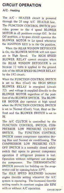

Originally Posted by bruiser
You can check for voltage on the light green wire in the engine compartment. You must have pressure in the system for the clutch to engage.
DUB
