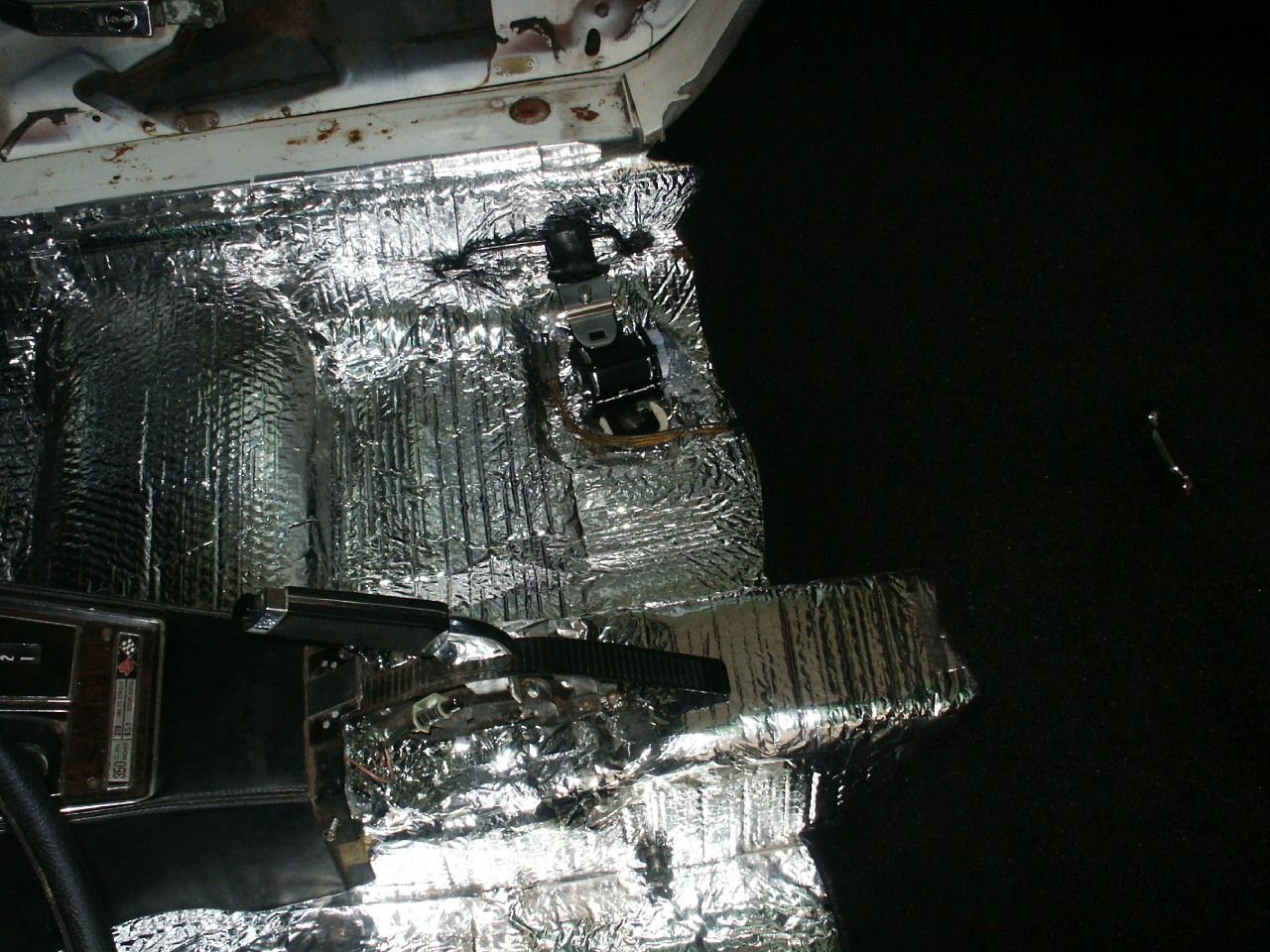

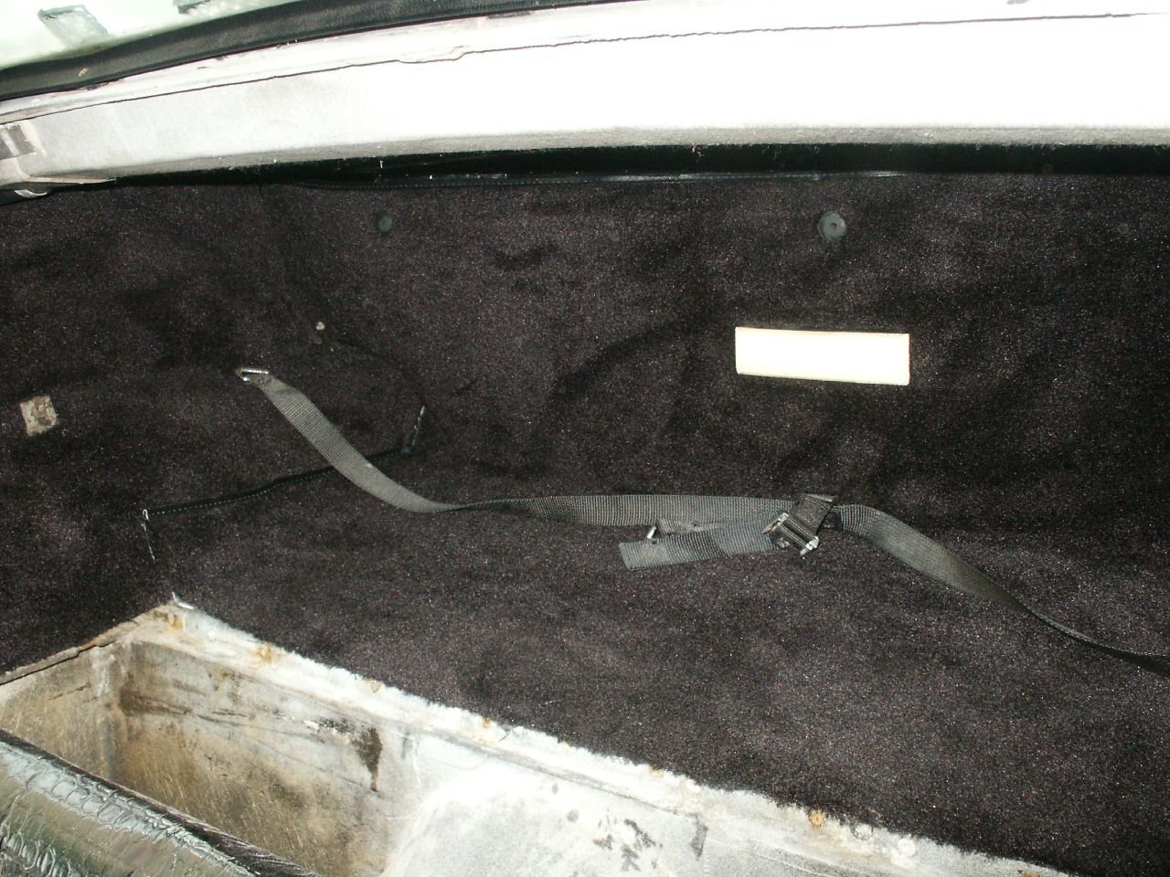

Here are a few photos of my 73 carpet replacement.
I had ACC carpet and it fit good for me. I had my old
carpet to use as a guide though.
Donnie

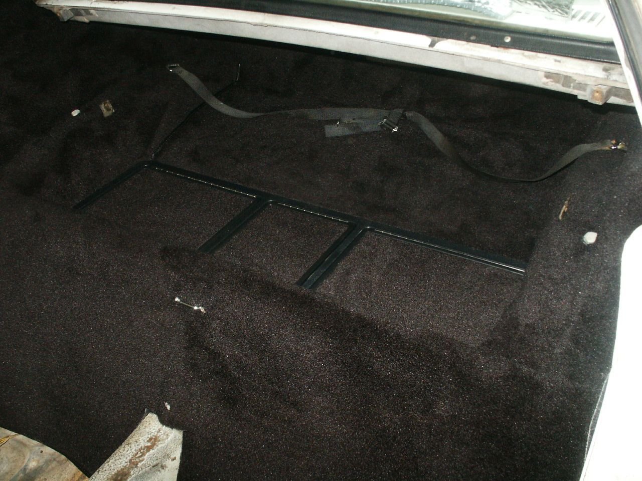

I wish I was at my office but I'm on the east coast for the next few weeks. I have a picture similar to this one only for your car. We worked with ACC to fix issues with the rear carpets over the last year and I have thousands of pics.... just not on this laptop.
This one might help you though.
Willcox
