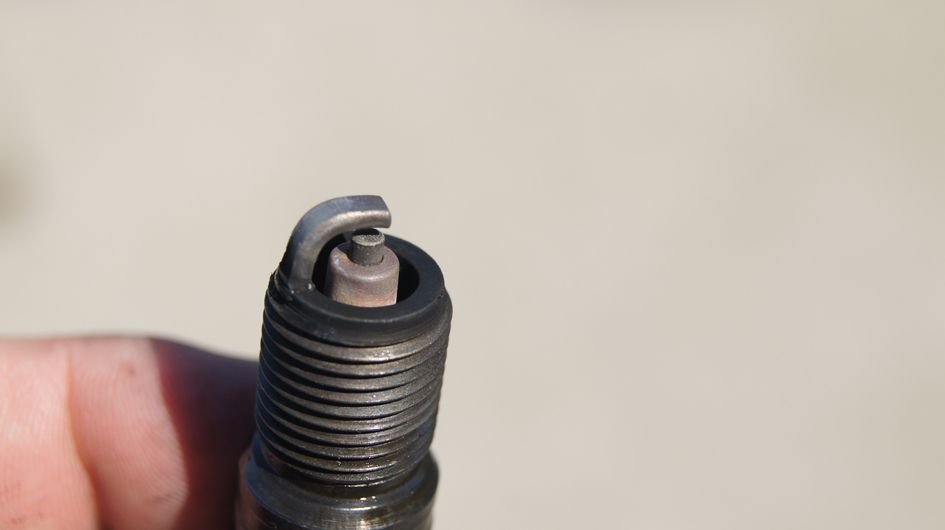

You have not made any mention of what the plugs look like. Without a AFR gauge this is the only other way you can confirm your lean theory. Show us your plugs.
This is a picture of mine. During WOT this reads as a AFR ~11.5 - 12.5. Idle is ~ 14. Highway running ~ 14.
I am running @ 2200 ft.
How does it run accelerating from about 1500-4000 in 4th ?
I would be looking at slow acceleration with-in this range.
Also any chance of plug wire cross fire or any possiblity of a wrong plug wire order ?

These aren't great pictures, but there isn't much to see anyway. As I was getting this car ready to bring back to life, I changed the plugs, and the new ones only have less than 35 miles on them. I've double and triple checked the firing order, because, as you know, it's easy to get wires mixed up going through all of the factory shielding, but they are right. They only thing I can't attest to is whether one or more wires are grounding out before jumping the plug gap. I guess that's my next thing to check.
I even started thinking that maybe the outer ring of the harmonic balancer had slipped; so I tried giving it 10 degrees more or less advance, but neither improved the performance.

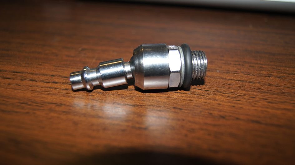

I would then next check the timing chain to make sure it didn't jump. It could explain the low compression of every cylinder. If TDC of the piston isn't timed to the valve's, you will have a open valve during compression stroke. If that looks good then I would pull. But you might be surprised to find the timing chain is not aligned properly or jumped. The other thing you can do is set the engine for TDC # 1. Pump air into the spark plug hole and listen where the air is excaping. If its via the carb then the intake valve is not sealed. If via exhaust then exhaust valve not sealed. If in the oil pan then the rings are not sealed ( if loud hissing) this is where I expect the air to go.
Get yourself one of these to plug into the sparkplug hole and connect a standard air compressor to. Set for about 5 PSI.
