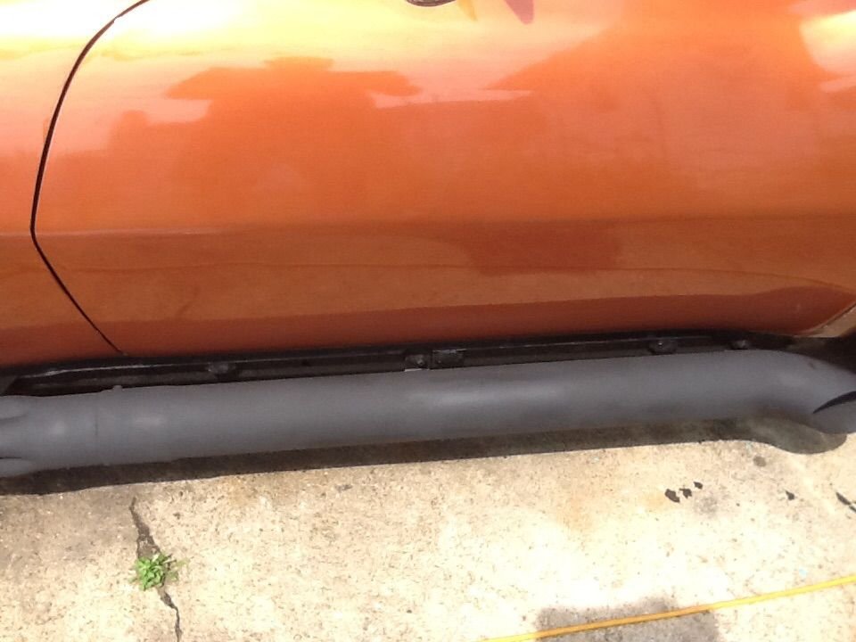

St. Jude Donor '15-'16, '18
About 24 in. Was all I needed to maneuver headers, had to remove plugs, oil temp send, and z bar, I used Dougs with copper gaskets so far so good. Still waiting to replace rocker moldings, didn't want to cut orig. sprayed area black for now, actually looks good enough to leave.
Can you post a pic? I may do the same thing.

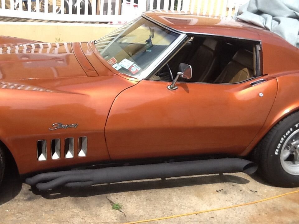

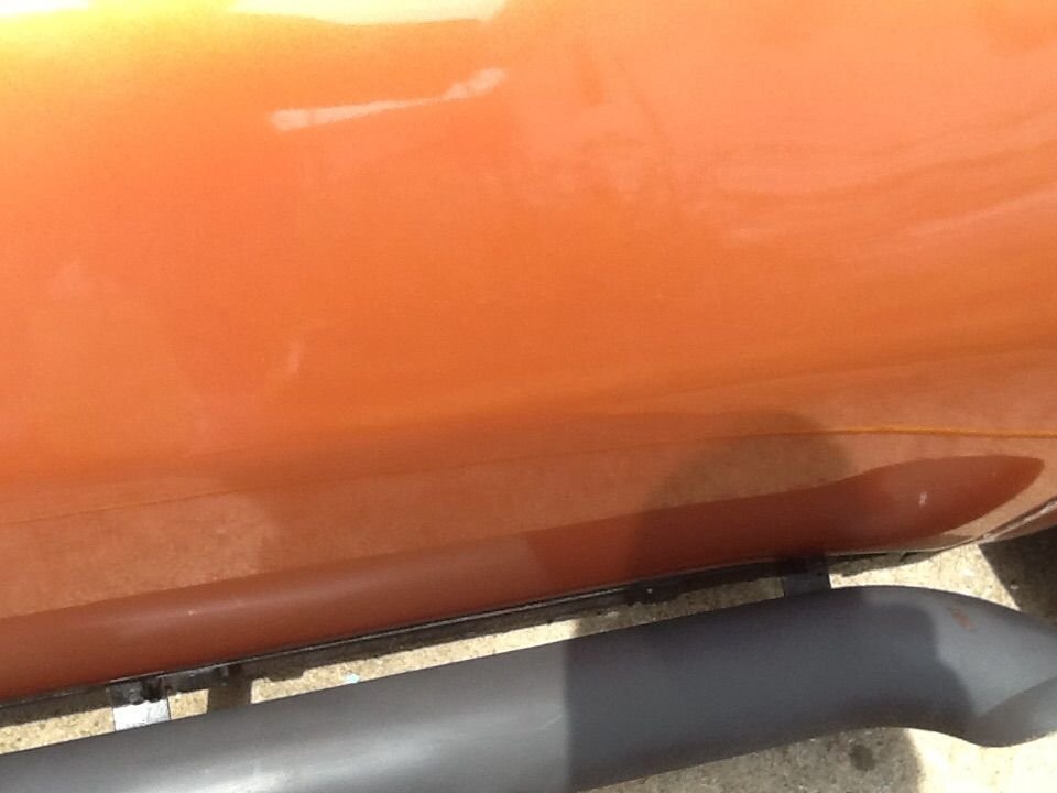

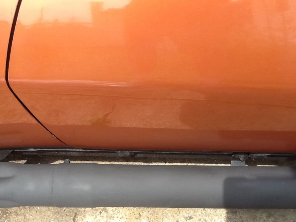

From: Long beach NY
Here are pics, consider car a 10 footer as far as paint, so this is good for me for now at least, you can judge for yourself,
Thanks!
