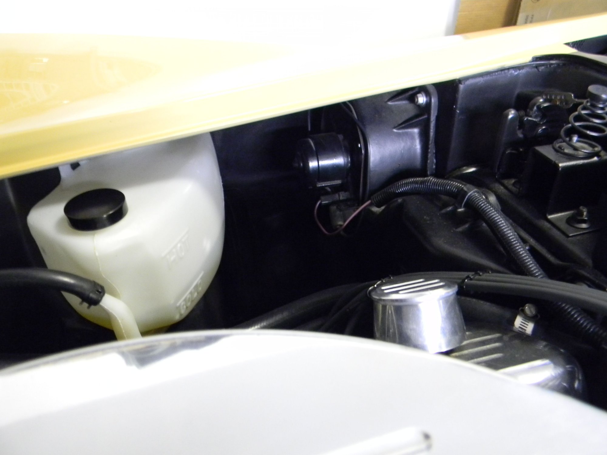

Originally Posted by John 65
Pulled the AC and rear glass out of my 77 and put in a pop out rear window from a chrome bumper car. It's not AC ....but surprisingly it's very comfortable even in the hot temps with the windows down and the rear glass out.
Then re glassed back half the hole in the firewall and in its place went a heater box from a non AC car. Rewired to not be on all the time as original, but only when needed. Very happy with it.
Curious.... why did you have to glass the firewall if you used the cover from a non-AC car? Wouldn't that cover the hole completely once you removed the AC cover? Was it because you swapped out the stock heater core for an AC heater core? Is there a difference? If I remove my AC components at the firewall and leave the heater core couldn't I just purchase a non-AC cover and install the blower motor into it and bolt it to the firewall or do I have to replace the core with a non-AC core? I didn't know there was a difference.
My mistake, I should have mentioned that the heater box that I used came out of a 69, needing a much smaller opening, but I would think that what you mention above should work.
