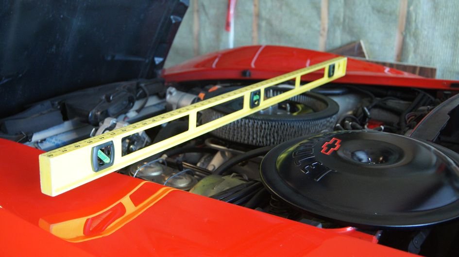

Is this normal for the engine to sit at a angle ?
I placed a level accross my air cleaner and noticed its sitting at a .8 degree angle. It is higher on the driver side.
Everthing seems normal while driving, but I was curious. Motor mounts are new when the motor was installed. Nothing looked bent / out of place ?

Less than 1deg - I wouldn't worry much. In a perfect world it would be level (side to side). I would measure from the carb flange and not the air filter. There is a certain amount of slop in the mounts, and the engine tends to twist up on the drivers side and down on the passenger because of its rotation direction. I would just check that everything was tight and in good condition - whether it was new or not. After this amount of time things could have happened in the past - and who is to say your fenders could be a slight bit off.

Fenders dont measure equal, but Using a digital level of the engine vs the level of the ground / pad in the garage.
I am just asking if this is normal. Any one with any measurements ?

I was doing something else in the garage and placed my level across the car on the air cleaner and noticed it wasn't even on both sides. I was just curious. I am not worried about anything just asking.

yes front to back, missed that he meant side to side. obviously it is supposed to be level that way...and yeah, <1 deg. side to side is nothing to worry about, considering variation in tires, bushing, ball joints, engine mounts, frame, etc...that's why they publish all those specs. if he wants to figure out what is off, start measuring and compare to the published figures...any accident over the years could have been repaired and brought "close enough", or just wear and tear...

I just checked mine since we have essentially the same ZZ engine. Mine is virtually level. I checked tire pressure and measured from my garage floor. I wouldn't be concerned about your setup.
