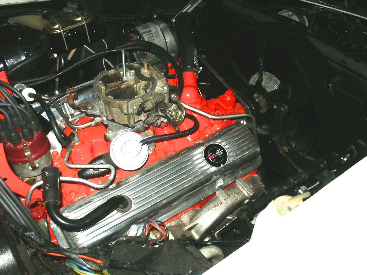

Originally Posted by upnorth
so the 3 I have left with 2 ports which two do I put together , have trans , spark advance and headlights . so if I put the spark on one and the trans on the other where do I hook up the headlights ?
You can see on mine that the booster comes from the back of the
carb on the metal tube with the rubber on the end.
The transmission and vacuum lines to the headlights are on the
fitting with the two outlets on the intake manifold.
I have mechanical advance and don't use the vacuum line on the side
of the carb that is plugged off.
Donnie
