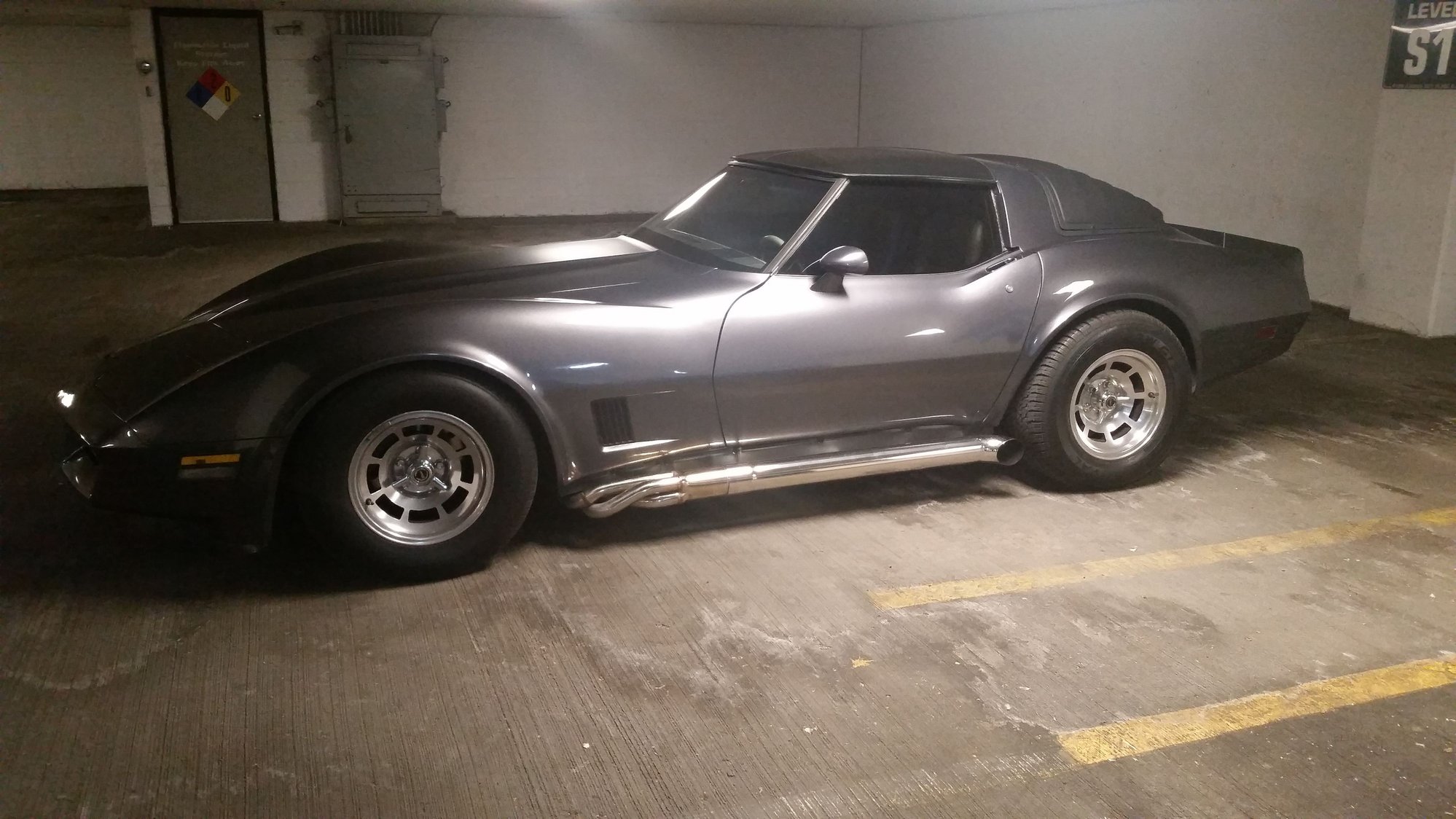

these are the OBX style side pipe headers with 3/8" flange and 1 7/8" primary pipes.i use the welded SS. insert resonators.install them in couple hours with zero clearance problems side pipe are about 1" adjacent to body trim and require no cutting what so ever then remove 350" and installed monster 409" SBC.the AFR full CNC heads were modified by builder and angle milled when i went to install primary pipe is touching steering box and passenger side 1/32" from idler arm.had to remove driver side valve cover.they just fit.

Old Jul 27, 2015 | 06:25 PM
