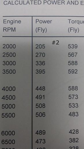

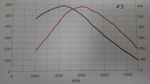

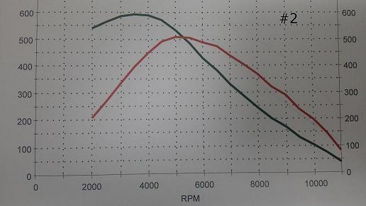

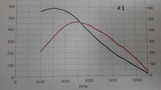

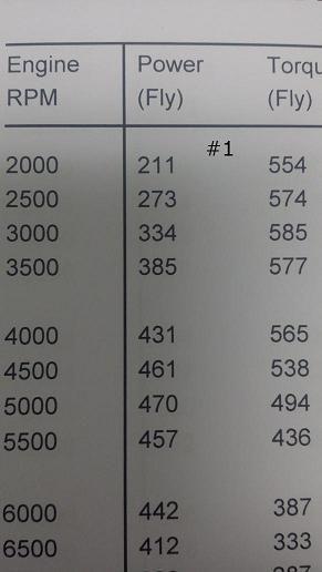

Desktop dyno comparison of 3 cams on the exact same engine combination. For comparative purposes only. Understand numbers may not be real world.
Fun street car, 3.36 gears, TKO 600 with .82 OD

I like the middle graph. I'm a torque ***** so the sooner and the heavier it hits, the happier I am. Is this a 540 BBC?

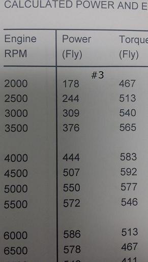

Of the lot, #3 would get my vote, particularly with the TKO 600RR's excellent gearset in combination with your rear ratio. IMHO it still has plenty of grunt without making coming off corners too ridiculously difficult while the others are just done too early. And, if those numbers do become real I'd be giving aero some serious thought should you ever decide to stretch its legs. Enjoy!
I agree, I like number 2.

For a street car I like 2. That almost flat torque curve will make for a great driving car. If you plan on racing I would go with 3 for the high rpm power.

#3 is the best for street and strip

Damn, mixed reviews between #2 & #3 like I thought I wish I could get the torque curve of #2 with the HP of #3. Decision decisions...
Motor needs to be limited to around 6000rpm, which is my hesitation with #3..

That completely changes the game. Out of the three I'd pick number three and probably look at going 1.6 to 1 rockers on the exhaust to help evacuate the exhaust. As it sounds like your already contemplating I'd go e85 and you could up the boot more and from the research that I've done so far, the methanol in e85 will help cool the blower and would work as well as meth water injection. I havn't installed my blower yet(mp122), I'm at 9.14 to 1 and cant get e85 but can get av gas but hope to keep it on pump gas. I hit straub up for a quote on the blower cam and also hit comp up for a cam shaft that was alot like the camshaft that I had already and they gave me lobe numbers out of the catalog that looked to be in the 230 range on a 114 with .543'' lift. Number 3 has twelve degrees more duration on the exhaust andwith a 1.6 it would do you well for the evacuation and if I'm not mistaken I believe that is the same cam that l82 kid is running, So you might want to hit him up and see what his thoughts on that camshaft are, other than the heads its about the same build.. any ways good luck.

So I guess the more I look at it #3 does seem to make the most sense. They both peak at 592 TQ, #2 @ 3500 and #3 @ 4500. However #2's HP peaks at 508 @ 5000k and then falls off. #3 keeps climbing and doesn't peak until 6000k with 586. (550hp at 5000k when compared to #2)
I'd be concerned that #2 may lose power and fall off a bit early. Although #3 would want a 6500 shift point in all out racing, it will still pull plenty hard all the way up to my preferred 6000k.
...I either just made a rational decision, or was blinded by the numbers and rationalized the decision I yi yi...

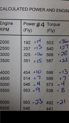

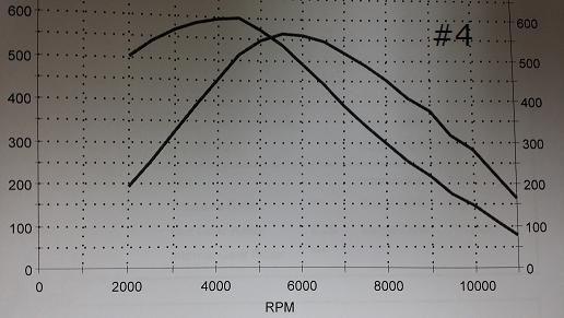

So I happened to come across another Comp Cam that seems to fit the bill. Looks to be a middle ground between #2 & #3.
Cam #4 Comp Cams XTREME Fuel Injection 268
218 / 224 @ .050
113 LSA
.570 / .565 (advertised with 1.6)
http://www.compcams.com/Company/CC/c...?csid=208&sb=0
(I also calculated this cam w/ 1.5 rockers (.534 / .529) for a fair comparison, but it was only 2-5 hp/tq difference. The photos are with 1.6)
It does not have the 10 degress + on the exhaust side that is typically wanted with forced induction, but the numbers and curve look good. The handwritten numbers on the chart are compared to cam #3, the Nitrous HP 276HR.
Gains a good amount down low and mid, with only a small loss up high.
If anyone is still paying attention, what's you take on it compared to #3?

Best compromise in a shelf cam No. 3
What the engine wants in a custom
540/.520
223/238
112
1.6 Ratio
Peak HP around 5800-6000
Peak torque around 3600-3800
