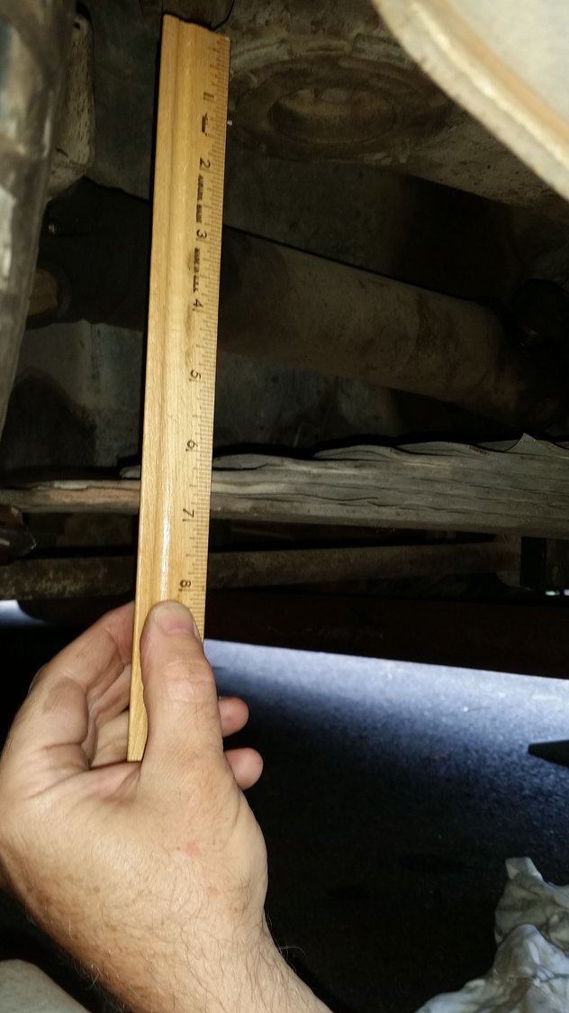

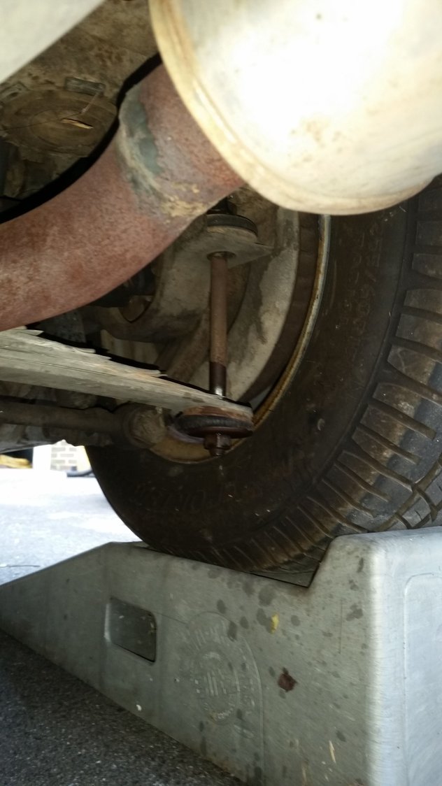

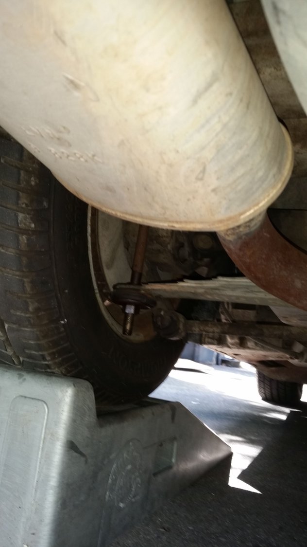

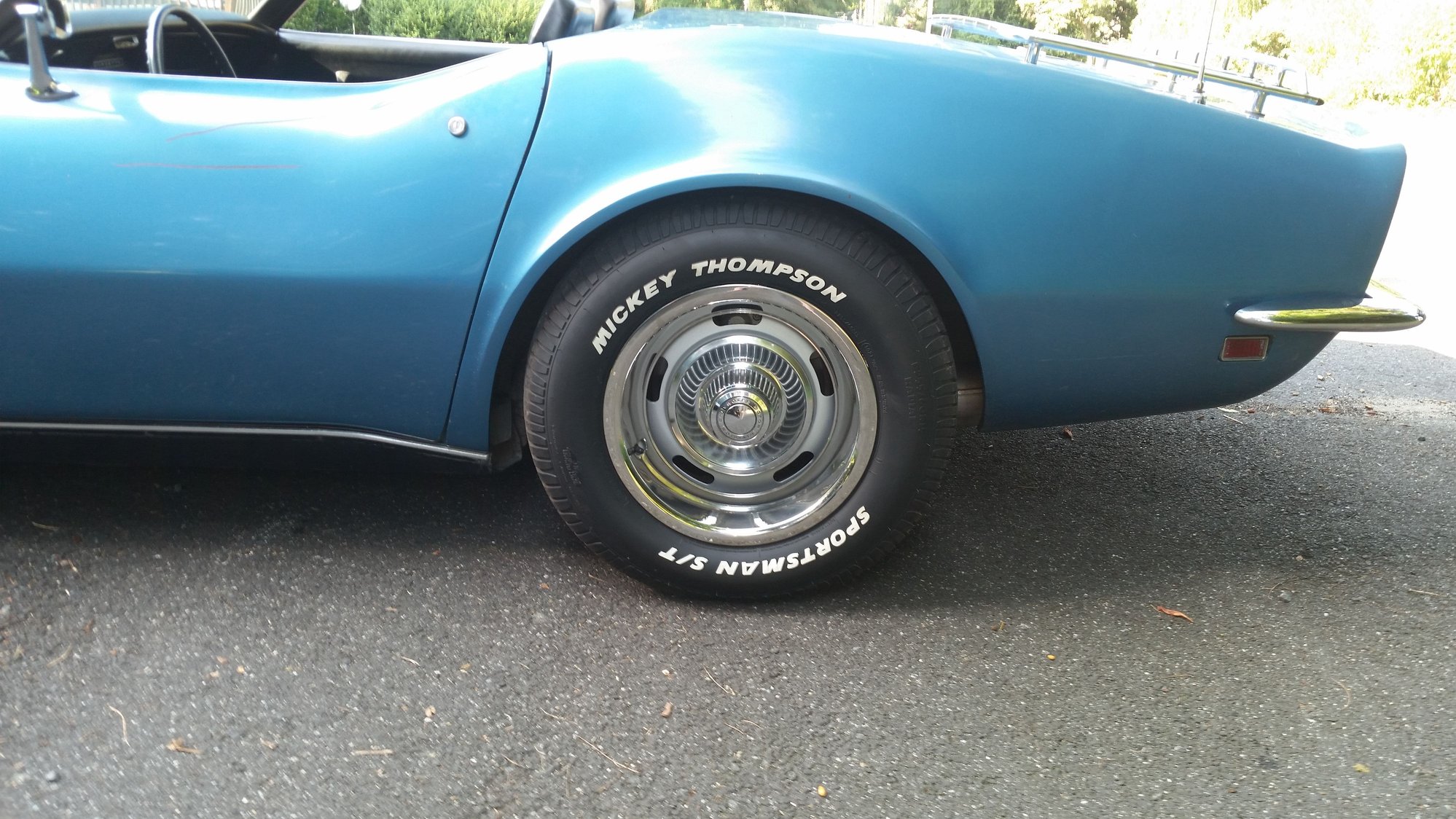

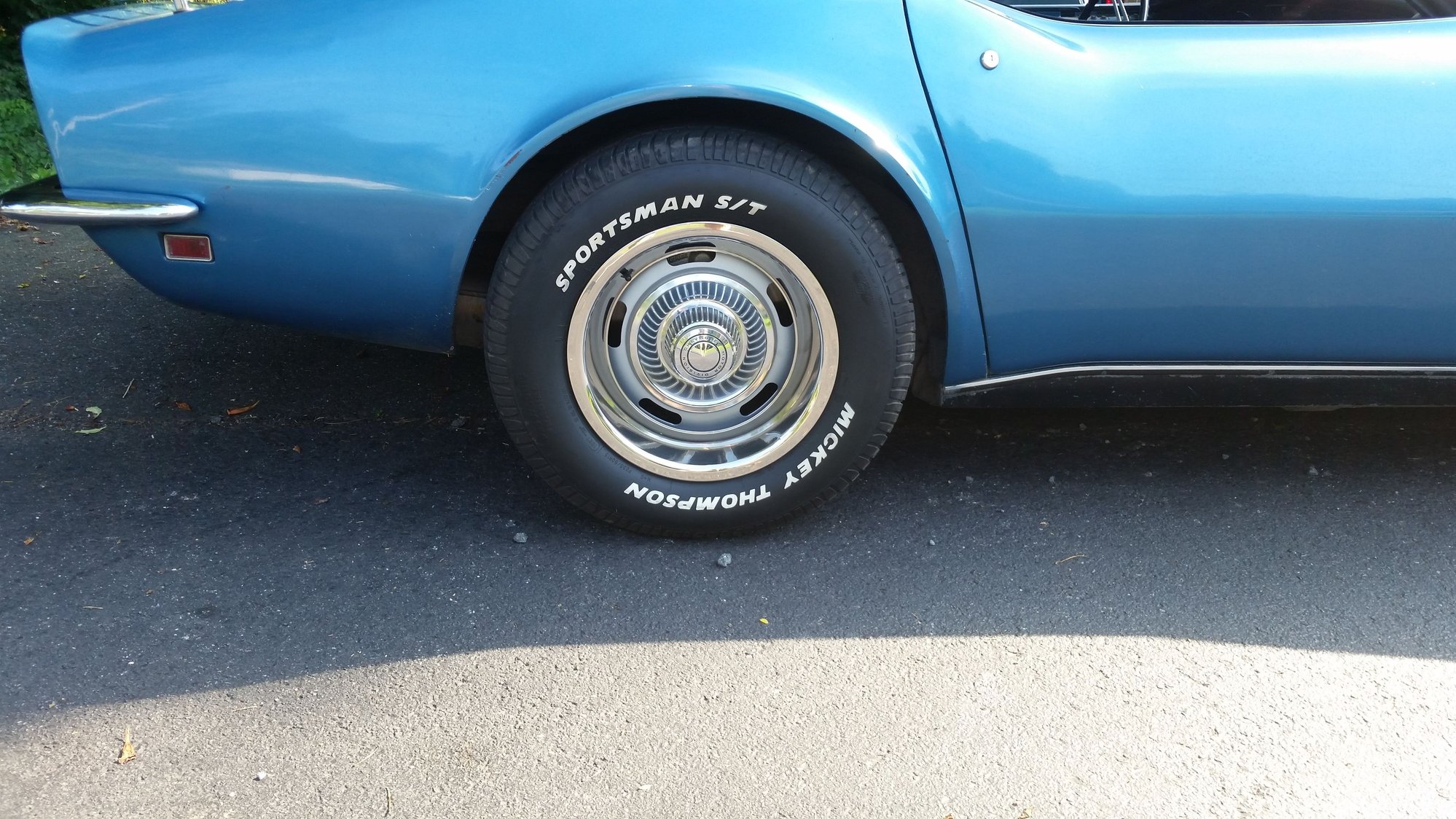

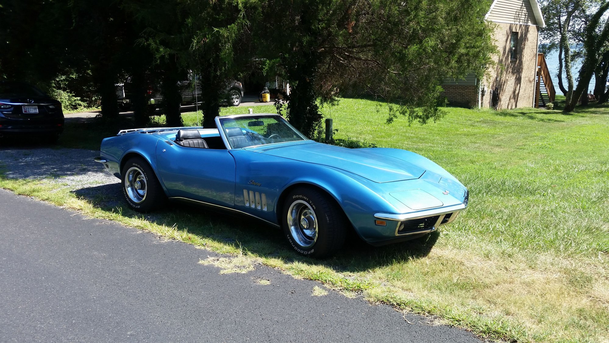

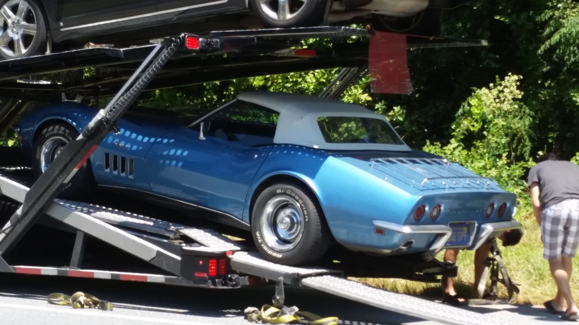

I don't have any great apples to apples/ same aspect pics to share but these will give you an idea what we're up against.
Note tire/fender gap
After adjusting RHS side down
After adjusting LHS side up
Rear crossmember to spring RHS
[I]Rear crossmember to spring LHS[I]
Even after extreme adjustment LHS is still low.

Ok. First of all we restored the spring bolts to where they were before and counted threads to assure they're equal. I measured the height from the ground to the lower wheel lip edge.
LHS: 26.5"
RHS: 27.5"
Here's some good pics of the ride height. You can see the bigget gap between tire and wheel well on the RHS.

Hi 69L,
That's a very nice looking convertible.
It appears that's a replacement spring of some sort and they're certainly replacement (longer) bolts.
It's likely that when this spring was installed the car sat high, so longer bolts were needed to improve the perceived ride height.
Without knowing what's been going on with the car it's difficult to assess why you're seeing what you're seeing.
Is it at all possible that there's a cracked leaf in the stack that you can't see because of the leaf liners?
Regards,

Alan, what do you think about those rubber bushings? To me, they look dead, which (I think) will have the body sit lower than if fresh bushings were in place, no? I have a friend that doubled bushings and got increased ride height out of it. Im not suggesting this but offering it to prove that bushing thickness vs ride height is relevant.
Regards,
Don
