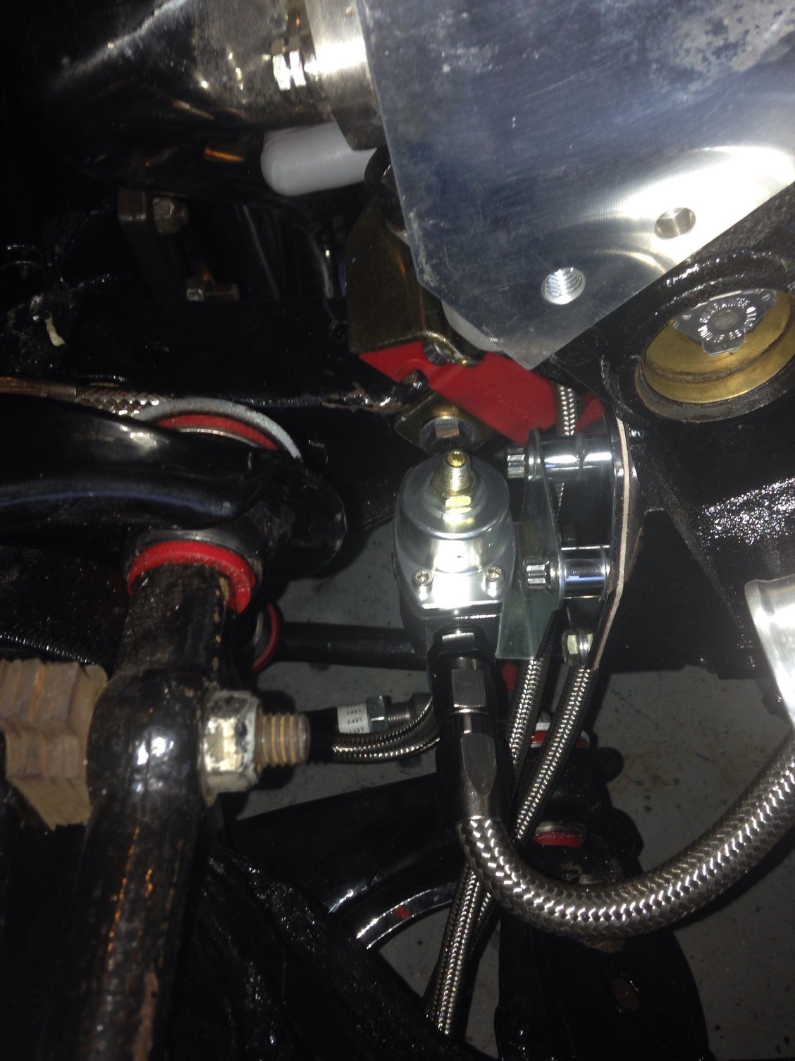

I read a few threads on fuel return lines. Lars has a great one with much information. Lars s is very clean, simple and functional.
I can plumb in that way with a return from a "T" at my rear supply line with a .060 bleed orfice to the stock 5/16 line back to the tank.
However, If Lars is available to answer, I would like to know if I can plumb the return line from my regulators gage port?
My regulator does not have a return port but does have a gage port. I'm thinking I can place the orfice there and run the rerun.
The gage port is a 1/8 NPT coming directly from the side of the regulator.

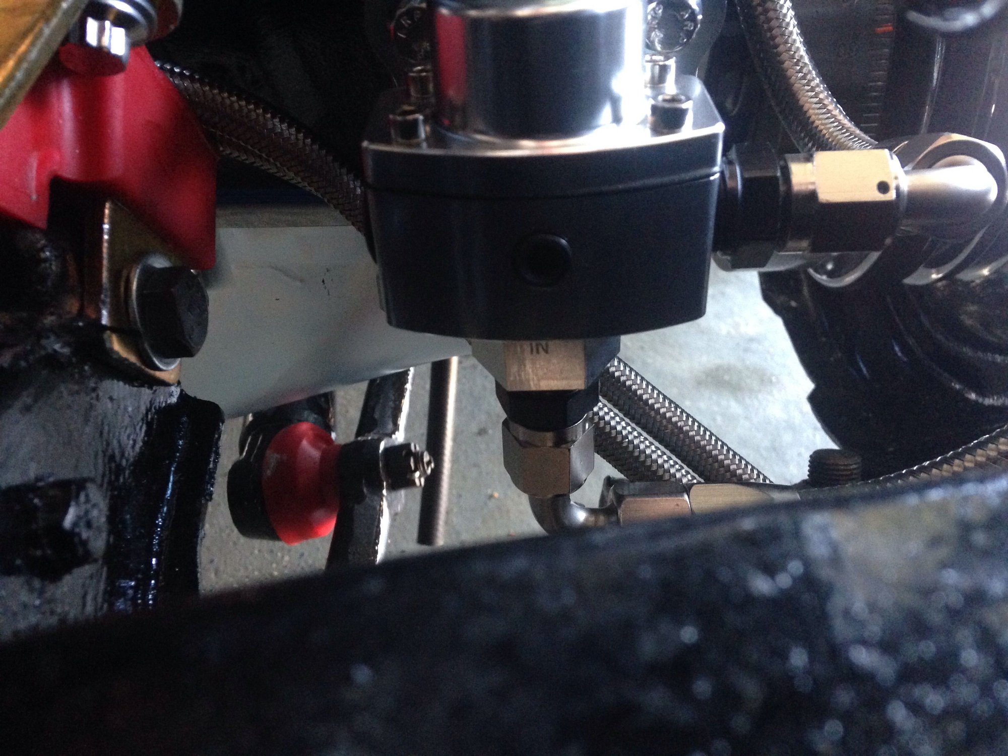

Here is a better view of the gage port on the side of the regulator. And a view of the fuel feed where a "T" can go for a return.
I like the "T" from the supply line design. However I would rather have the return coming from the regulator.

I don't know that regulator to tell you either way, but it might work. If it were me, and I wanted cooler fuel, I would pick adding the T at the carb. If you put the return down there at the regulator, fuel will be sitting still in the line to the carb and pick up heat. Of course if it were me, I would want the regulator right at the carb as well.

Never seen anyone use the gauge port for a recirc but the gauge port is at the reg outlet pressure and if using a orifice restriction i dont see why not for a return line. Anything down stream of the reg prevents the fuel press to carb from "dead head" and electric pumps or the carb needle and seat dont like that. Your tank return line should be very close to that reg location and a short piece of flex line should work very well. Your '78 should have a return line to the tank unless its been removed. Thats a clever reg mount on the fuel pump casting pad.
My self i like the return to start as close to the carb as possible and of course use a tiny orifice restriction (0.040'-0.050"). I think i see a holley carb in your pix and a possible location is the opposite side inlet (drivers side) to the fuel bowl. That should already be threaded but u will need another mile of fuel line to go around carb and down to the tank return line (well maybe only a couple feet) but attachment/installation could be fast and simple.
