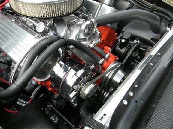

One example would be my 77. No Corvette only, brackets or pulleys. Works well. You should be able to use your stock hood also. Good luck, lots of fun.
