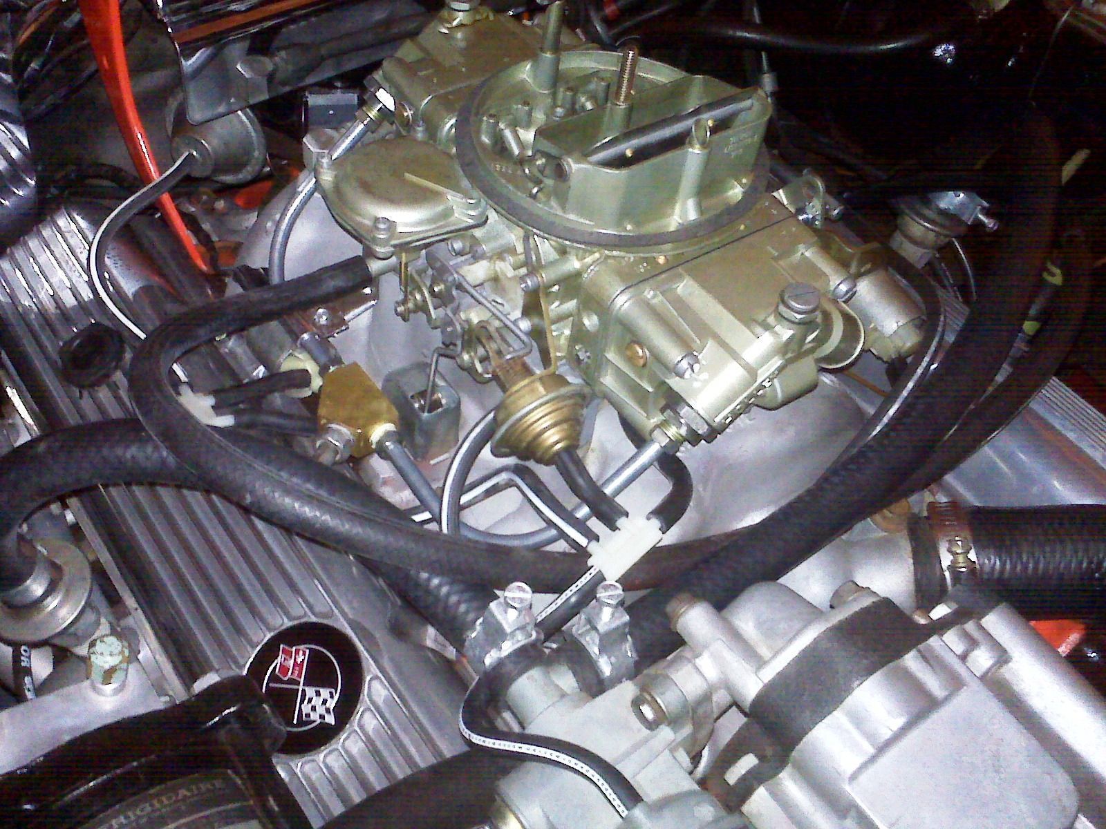

This correct Holley carb was on my '72 LT-1 with A/C. After I had it rebuilt and finished it ran perfect on that original motor.
1972 LT-1 with factory A/C (1 of 240)
Curious, with what size jets??

I forget what size jets it had. But I kept it stock original. I sold it just before the d-i-v-o-r-c-e. It went from NJ to Phoenix, AZ, where the new owner bought an identical twin to this one. I restored that engine compartment to show quality, and just finished the one on my '66 427 convertible that my brother bought new. So I hang out in the C2 area now! But I've owned two LT-1's and love 'em.
1972 Corvette LT-1 with air conditioning. Fully loaded. Medium saddle interior. Matching numbers.
