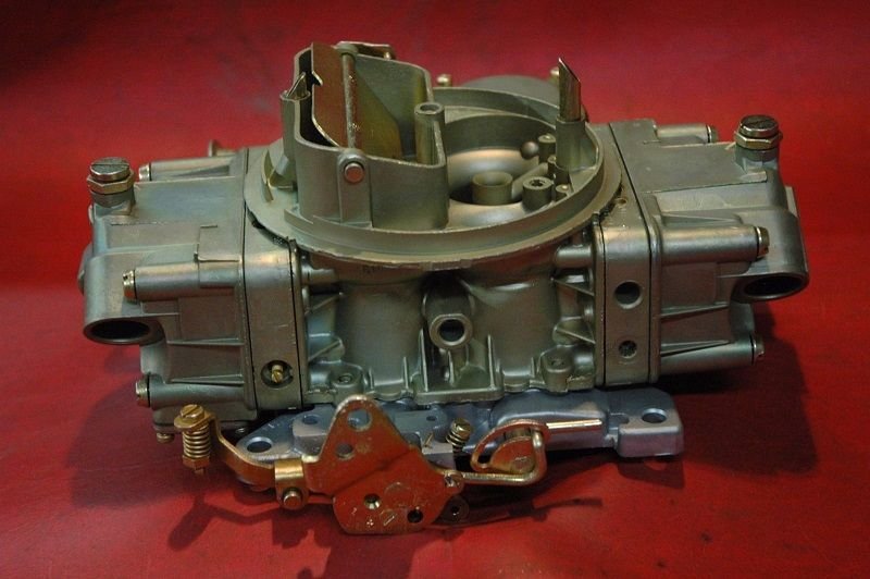

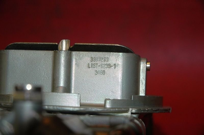

Old Aug 11, 2015 | 01:00 PM
TheSkunkWorks's Avatar
TheSkunkWorks
Joined: Apr 2007
Posts: 7,353
Likes: 72
From: Graceland in a Not Correctly Restored Stingray
If you've a legit LT-1, whatever you do, don't choke it down with an undersized aftermarket carb. Best options IMHO are to rebuild your original (hang onto it either way) or replace it with the same model Holley.
