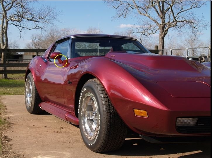

If you have the factory Sport Mirrors, you may already be aware of this and I apologize beforehand if you are. Many folks unknowingly purchased and installed Camaro/Firebird sport mirrors on their Corvettes back in the day. They were more readily available and often less expensive. Unfortunately most folks didn't realize that there was a difference in the two mirrors, they appear identical unless you see them side-by-side or measure them. The Corvette mirror has a pedestal that is about an inch taller than the F-body mirror pedestal. This inch makes a substantial difference in the rear view.
This is what the pedestal on the Corvette looks like...
It doesn't provide a perfect view, but it is much better than the view through the F-body mirror.
Good luck... GUSTO
