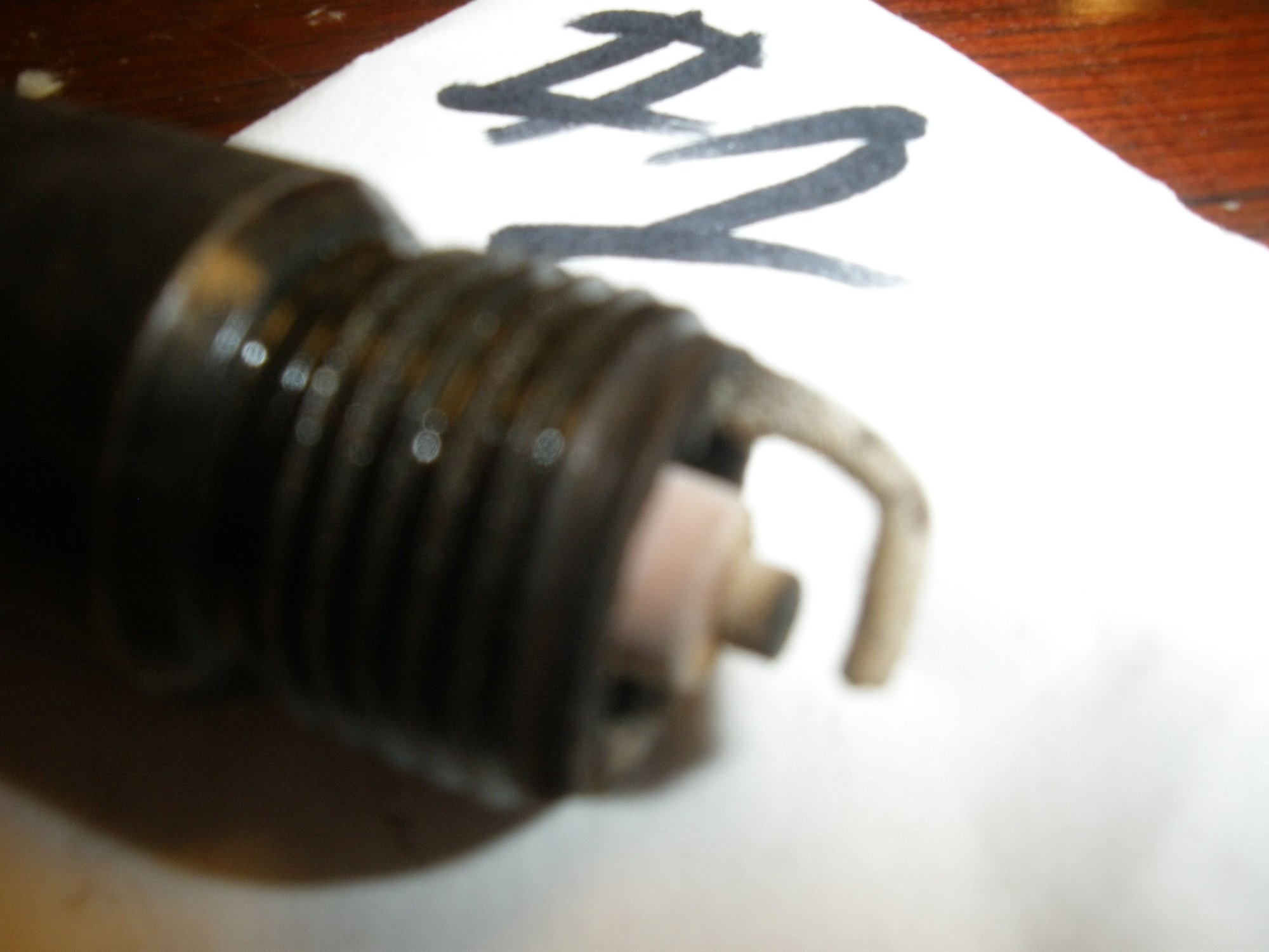

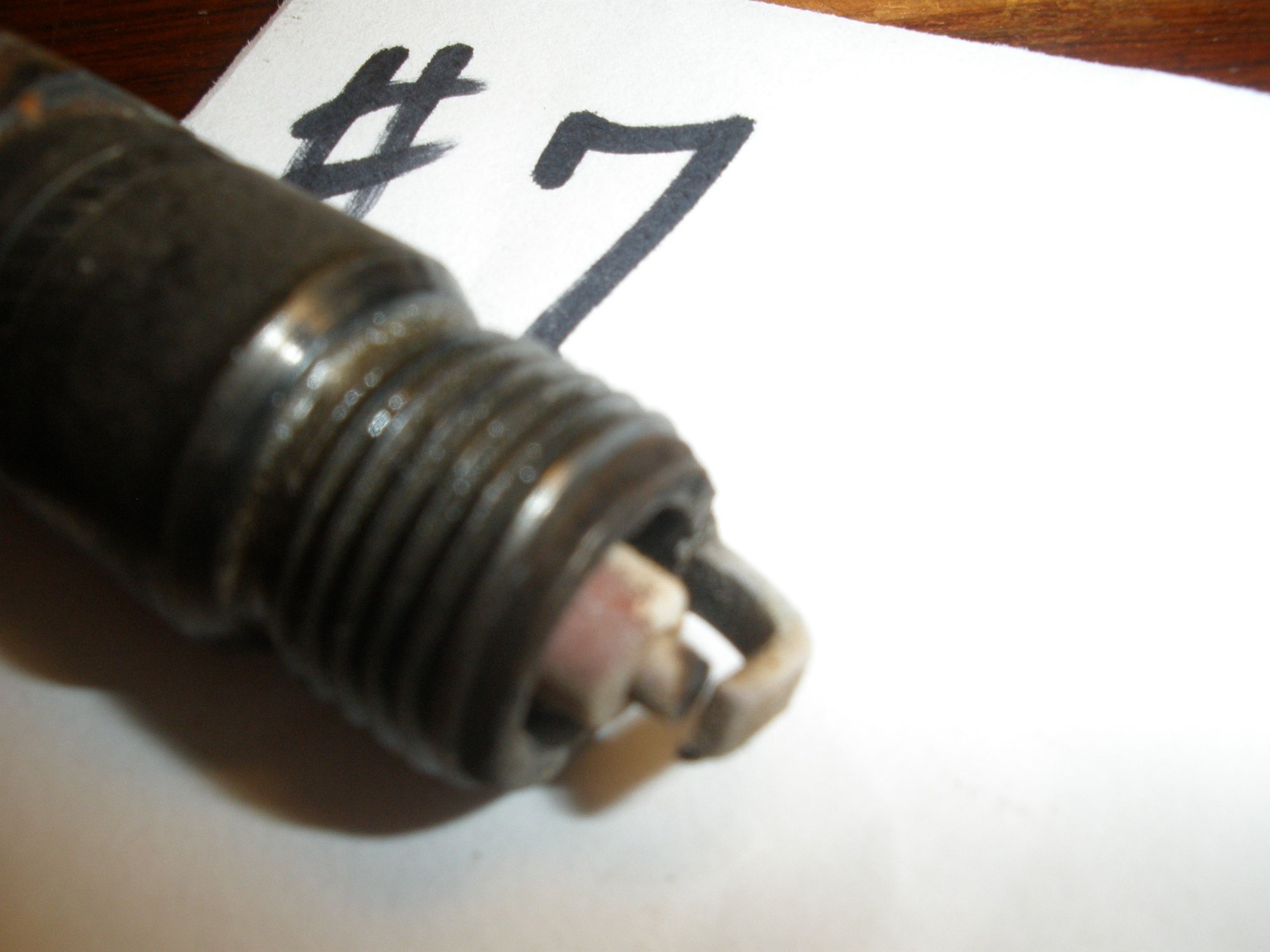

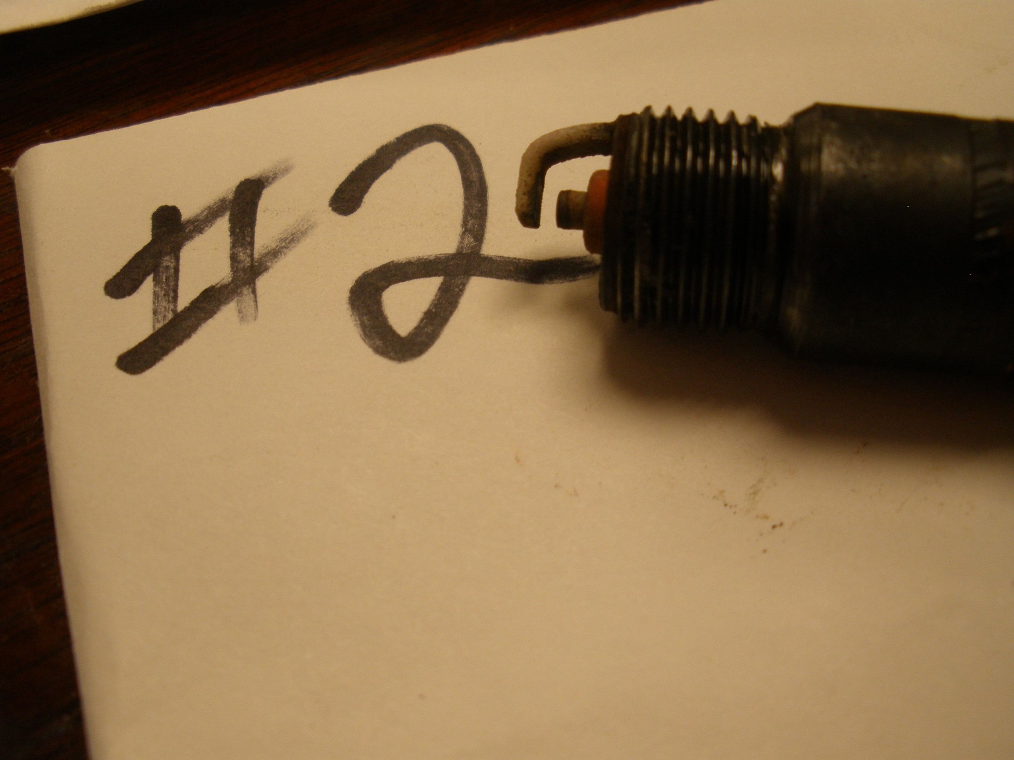

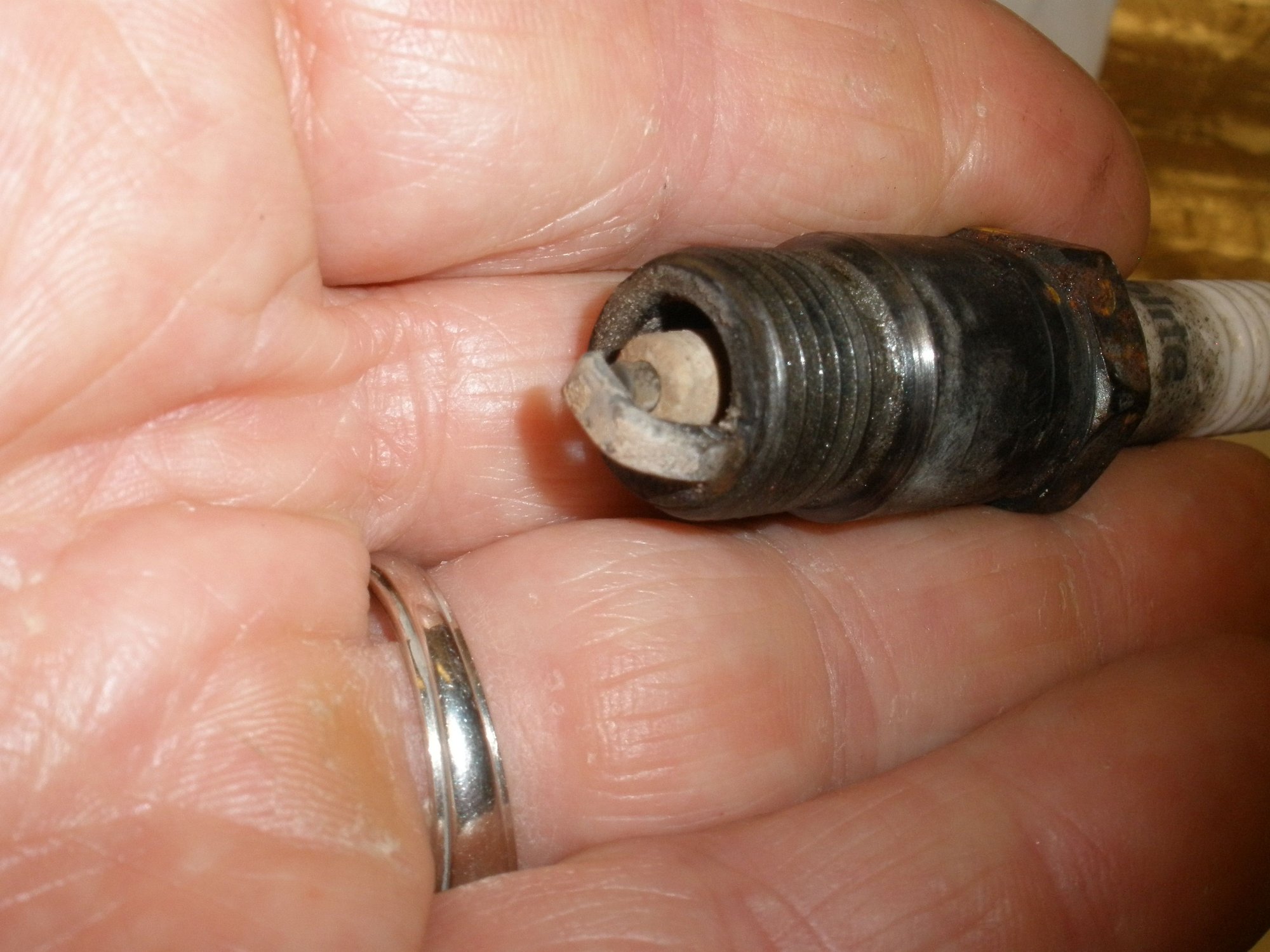

For further help, here are pictures of the spark plugs I pulled out
The plug in my hand is from cylinder # 2.
They all appear to look the same. No idea how many miles are on them.
My guess is that the white residue is from leaking coolant?
I filled the radiator full and have traveled a little over 200 miles. The level is now down about 3/4 of an inch.
I never see any blue of black smoke coming from the exhaust. Even at WOT. When I start it cold there is nothing coming out of the exhaust for a short while. After about a minute I see white smoke and some water droplets. If I hold my hand under the exhaust it will become saturated in about 30 seconds. After the engine reaches temperature the exhaust is completely dry. I would think some moisture coming from a cold engine is normal but think what I have is too much and I am in fact leaking coolant.
Do you think a leak down test is in order? Or maybe just a simple pressure test with compressed air to see if and where anything might be leaking that doesn't show up in the compression test?
Thanks for reading all this! Best of all thanks in advance for your input.

Your engine seems fine to me for a 70"s vintage V8 with that kind of mileage. Ring seal is fading from use which is normal.
My guess is #2 could be carbon on an intake, or exhaust valve since oil in the cylinder had no significant impact on PSI produced. I guess if it were mine I wouldn't worry about it too much.
I might try some kind of top end cleaner in the fuel to see if it improved, or if you felt comfortable with it water down the intake to clean out carbon deposits. However if you still have a catalytic converter in it the water could make things worse for it.
Does your radiator have a recovery system? It sounds like it does not.
If not, then due to normal expansion you are going to puke some fluid out of the radiator at running temps. Then when it cools the level will be lower in the radiator. No way around that without a recovery system.
The plug looks good to me. No real evidence of oil burning. You could just leave it alone.
As far as moisture after starting and warming up, that is normal. Burning water is white smoke. Look for that.
