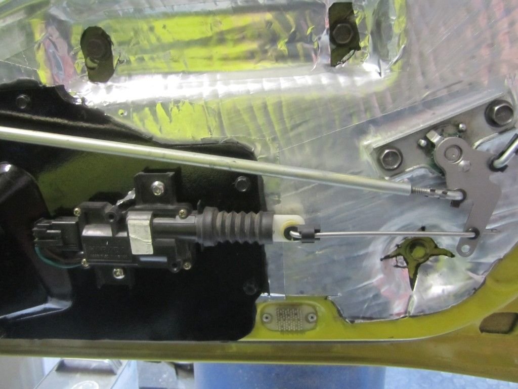

Here's one of the better ways to connect the linkage so it doesn't bind up-

Here's how I hooked it up on my '71.

Notice a common theme going here.
Only issue is making sure the lever arm is the right length to ensure you have enough force from the actuator and yet still have enough travel to lock/unlock.
I wasn't sure and put two different hole locations in just in case.
M
