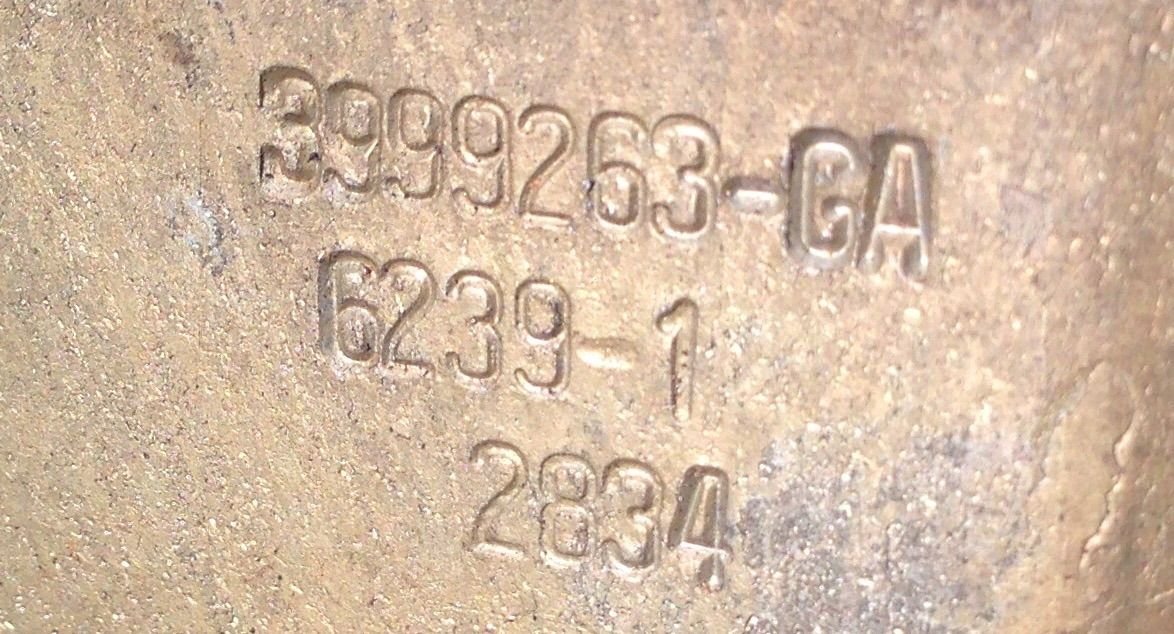

I would like to know the car year, engine size and what carb number.
A picture can tell loads.
C3 corvettes came with several engine size, configurations and carbs. Plus many owner's modified or replaced engines. Hard to say what you have.
I have a 1972 convertible with AC. VIN ends with a K. Engine is a small block 350. Engine block code is 092TAX. Based on my research that means it either has 255 HP and came out of a 1970 Chevy pick up or it has 175 HP and came out of a 1972 Camaro. I can't find the date code. There are several numbers on the carb. Here are a couple pics.

That was quick.
I hope Lars chimes in on this.
The Holley carbs I have seen on Corvette applications had 2 port fuel pumps with a vent line on the inline filter and the pressure lines were steel tubing with hose on the vent.
That is not to say GM might have used a 3 port fuel pump on Holley applications similar to the Q-Jet set-up on most L48 engines like mine.
