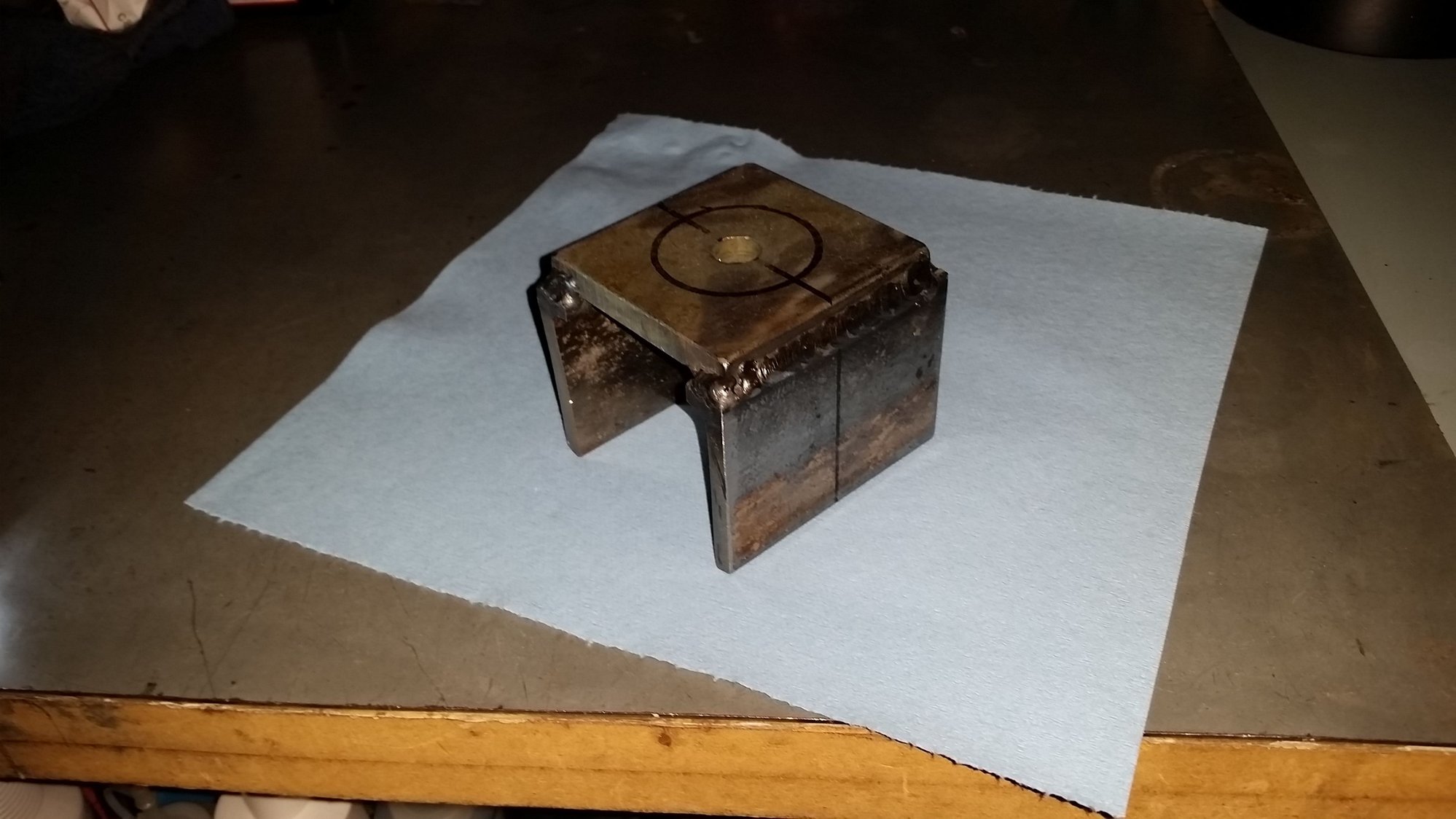

I built a jig to press out u-joints with my press. Measures about 3" length & depth, 1/4 " steel plate. The line on the side is center point, place that directly over the horizontal trunions as situated on the press (caps off). The circle on top is the press contact point . The hole is of no value, just scrap I had. I used a short section of black pipe underneath the lower cap for it to exit through. Using something like this avoids bending anything. My advise on installing the joints is forget the press. Tap caps in with a hammer and ring the flange as you go if you want joints to be free when the snap rings go in.
