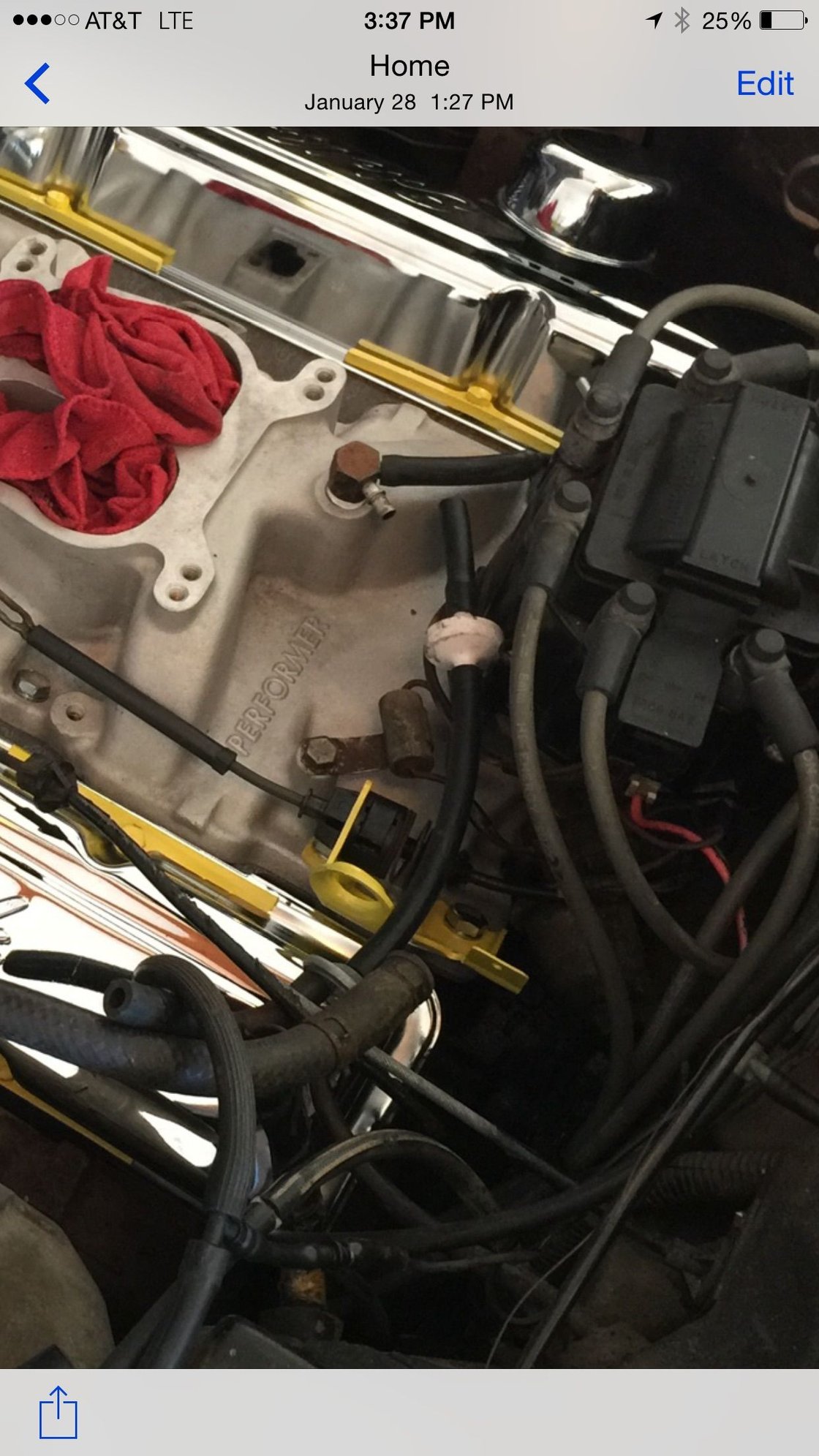

Hmm.. Maybe that the little relay/resistor has gone bad. It's the small inline block on the tach wire that bolts next to the distributor.

Originally Posted by Strokemyaxe
Is that the tach filter?
My fuel gage is also all the way to the right (always reading FULL). I just noticed that the tach and the other gauges use a printed circuit board. Is it possible both boards are bad?
Old Aug 25, 2015 | 11:11 PM
Strokemyaxe's Avatar
Strokemyaxe
Joined: Jul 2014
Posts: 831
Likes: 54
From: Arlington TX
Yeah.. the tach filter. Just bypass it and see if anything changes.

I had time today to look around for a tach filter but there isn't one. The spot where yours is bolted to the manifold is empty. There is one white wire coming directly off of the distributer...maybe that's it tach wire?
Then I would buy and install the filter first, and see if that clears it up.

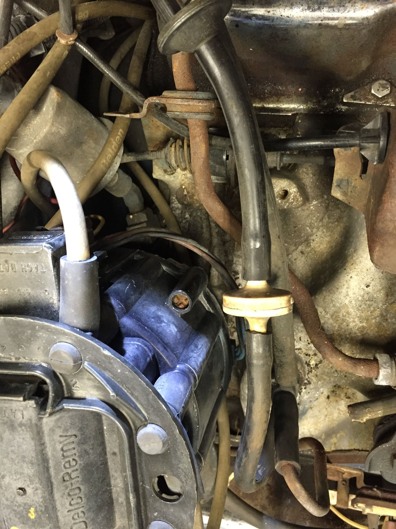

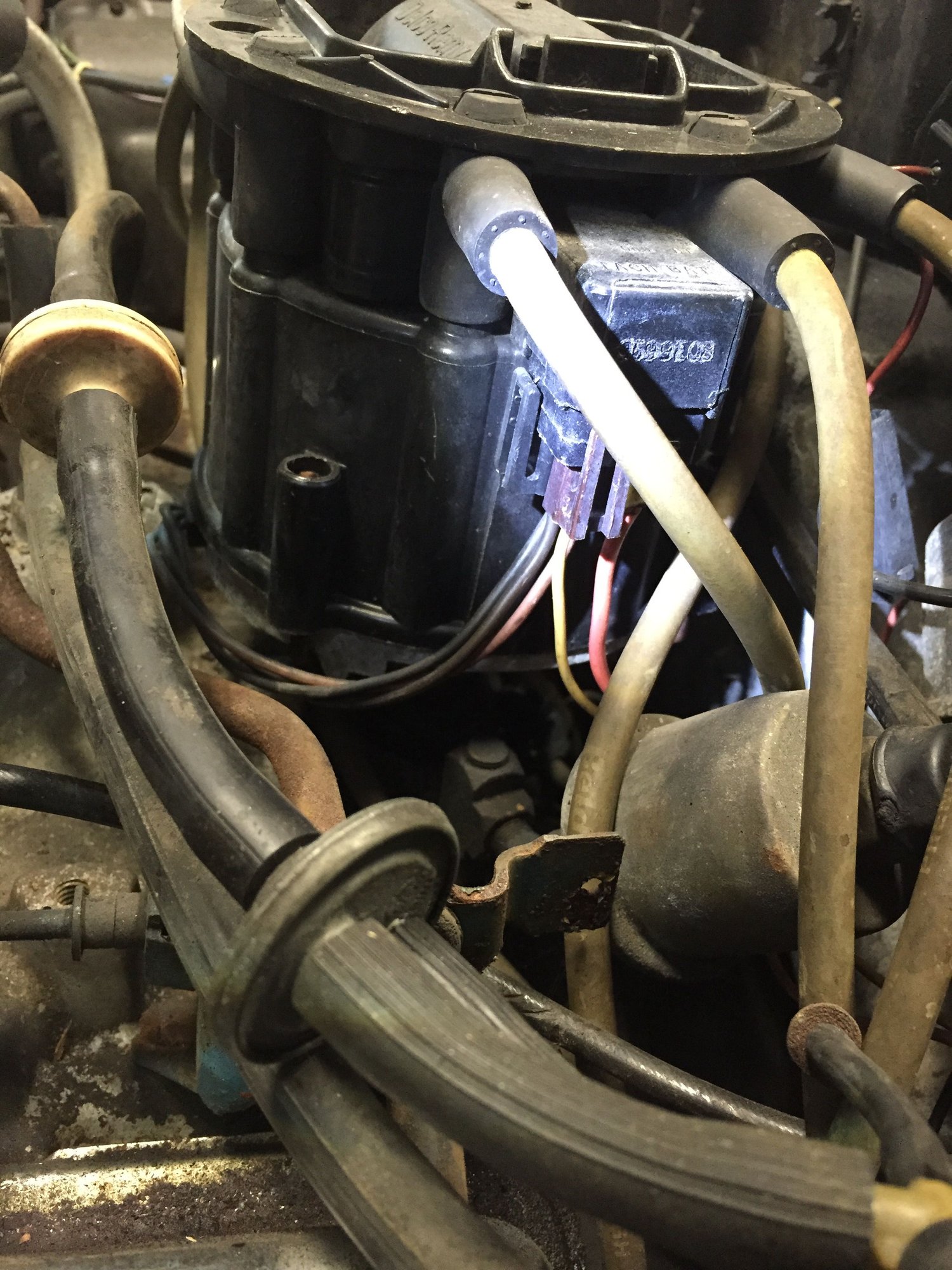

Likes: 7
From: Lewes Delaware
(Yes, tach is white)
This is what my dist and area around it look like.

This is what you should have. By-pass the filter and plug the tach straight to the distributor and see if anything changes.
It appears that the PO already did that (no tach filter found). So, my guess is that your first diagnosis of a bad board is correct. What is the cost if I send in my tach for your guys to install a new board and calibrate? Also, would I need a filter?
Not necessarily. It is indeed not mounted to the manifold. But It could be hanging loose on the back side our down below. But I will say that it is looking more and more likely to be a "grounding-out" issue.
I checked that. The white signal wire exits the wire harness near the firewall and runs directly to the dist (nothing in between).
