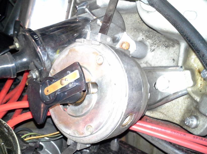

Its an electronic dist without vacuum advance, but I believe a vacuum leak could still be causing the pinging correct? Maybe I should plug the vacuum fitting at intake manifold for the lights/wiper door systems and see if it still pings.

It doesn't have a vacuum advance? Please give us a picture of it so we can see what you're dealing with. Pinging would indicate timing too far advanced for the octane of gasoline you're using.

I'm not sure what you mean by "electronic dist without vacuum advance". A previous owner replaced my points ignition with electronic ignition, but I still need vacuum advance to run properly. I see you posted a too-close, badly overexposed picture of your distributor. We need better pictures to get an idea of what is going on here.

Not all distributors have vac advance. It looks clear from the photo that he doesn't have vac advance. It's not "needed".
Back to the original post. Your distributor could have slipped. Make sure the hold down clamp is tight. Either way, best to start with checking timing like others on the thread have mentioned. Your base timing is probably going to be more advanced than the factory settings, but you can find them here for reference:

So the distributor has no vacuum advance, but it's probably has a mechanical advance, you need to Google the distributor and figure out how to get to the mechanical advance
Chexk it to see if it's all good, if so try adding more fuel and check the timing. If it's all good and still pings it might be carbon build up which can be cleaned by running water through the cylinders while running.

i have a feeling evereything is computerized with his dist. we have no vac on boat distributors cuz there is no such thing as light load except at idle. dist has about 22 degrees of advance built in and comes in total by 3500 rpm and doesn't care about throttle load. he needs to get a good light and check his total advance curve. he probably doesn't have enough total advance so is running too much initial. vacuum advance is for gas mileage, not performance. OP you need to remove that boat distributor from your car...i could use it on my pantera...

Looked at the dist and there is dime size hole that looked like it might have been for a vacuum advance at one time.
