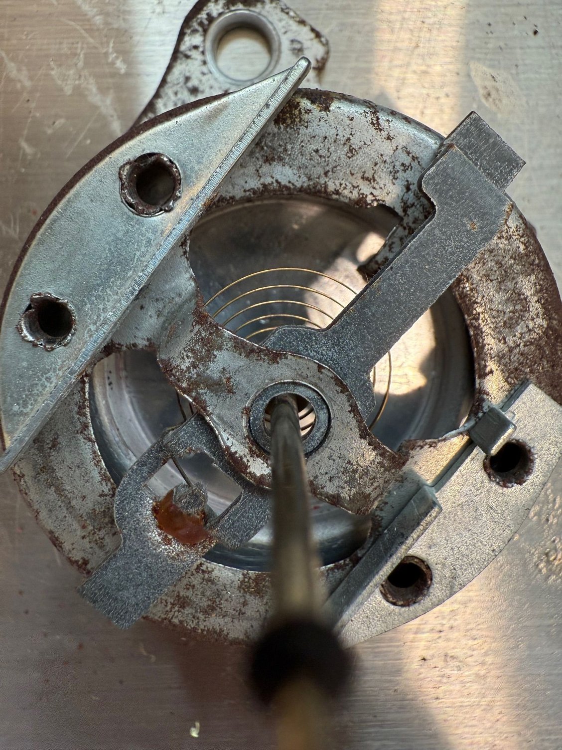

I have mine apart to replace the odo gear. The bushing looks fine. I didn't pay enough attention to the speed cup when I took it out. It is up against the zero stop in this picture. Does it look like the gold spring is wound enough? I'm concerned that I might have jumped over the stop and I let it rotate a full turn counter clock-wise, which I believe will make the speed inaccurate. I assume the spring tension needs to be right to offset the speed cup pull for the speed to be correct.
