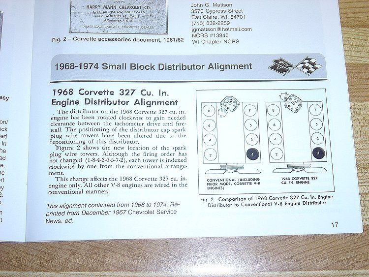

I just thought of an issue where the distributor could be clocked to a different position to relieve the pressure on the tach cable. There was a GM Bulletin someone posted on the CF about that. When the distributor is clocked in this way I dont think the wire diagram will align in the traditional way that we think it should. I seem to remember it will be off by +/- 1 spark plug wire position all the way around.
Would this be similar to the question you had about the spark plug wire position in the distributor cap.
Prior owner or whoever did that. Reset new wires accordingly 18436572 stating at 7,

Here is a link to a thread about clocking the distributor. Paul74 had a photo of the manual showing the orientation.
https://www.corvetteforum.com/forums...butor-cap.html

And if you want to increase the lifespan of your distributor cable, you can follow this chevy service bulletin. I just did it after my cable broke.
Edited to add: Oh wow, in the short time between posts this one became redundant. This is probably the photo referenced above.

Interesting bulletin. I'm not sure if this was done intentionally to my vette for tach cable issues. I personally think whoever set or reinstalled distributor didn't know factory spec install procedures.
