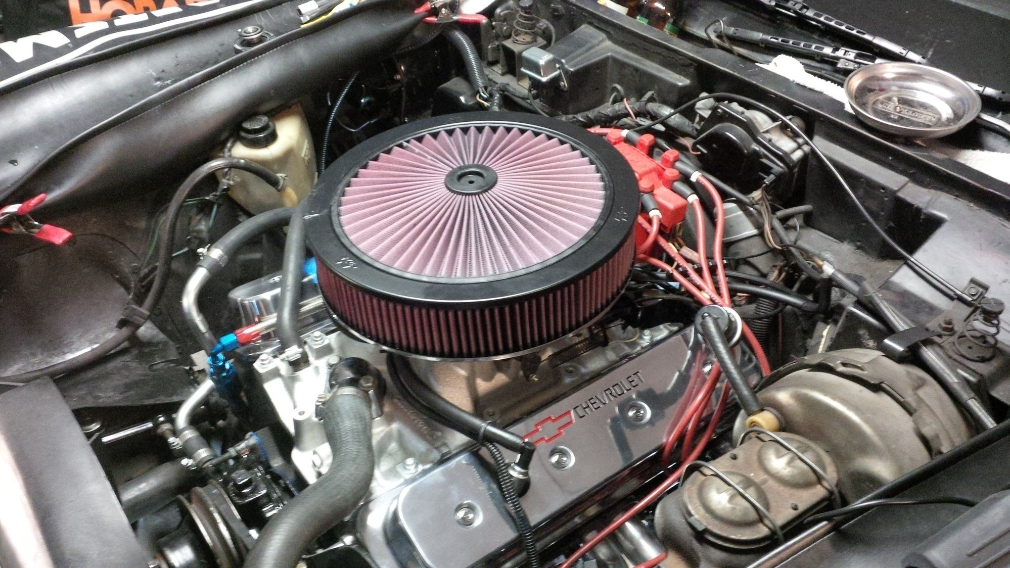

Vette's been driving great all summer, but lately it has developed an intermittent 'miss' where it seems to just lose power for a split second. It often happens on a slight grade uphill and at part throttle but has also done it at full throttle. Usually when I give it more gas also from part throttle. Then this morning driving in to work, after going through first gear at a about half throttle, and letting off to change gears, it backfired! Never done that before. So I don't know if that is a good clue for something to check. I thought maybe it's running rich?
Background on car - engine is crate 350/330 with vortec heads and Comp XE268 cam. MSD dizzy. 4 speed.
I haven't looked at it, I will probably look into it this weekend. Maybe a stuck float? Carb is year and half old Edelbrock 650 which I've had no problems with (so far). Fuel pump I replaced this winter with AC Delco from rockauto.com. What about fuel filter? Should probably check/replace that. I'm thinking the backfire is maybe the best clue of something ?
anyways - thanks in advance for help

Great looking engine compartment there Jim. My 81 started doing the exact same thing you described, but I'm still running the stock ECM, actually the ECM on mine just crashed. I have another on order but if it gives me any more trouble I'm disconnecting all of it and going with a Holley carb and a vacuum advance distributor
