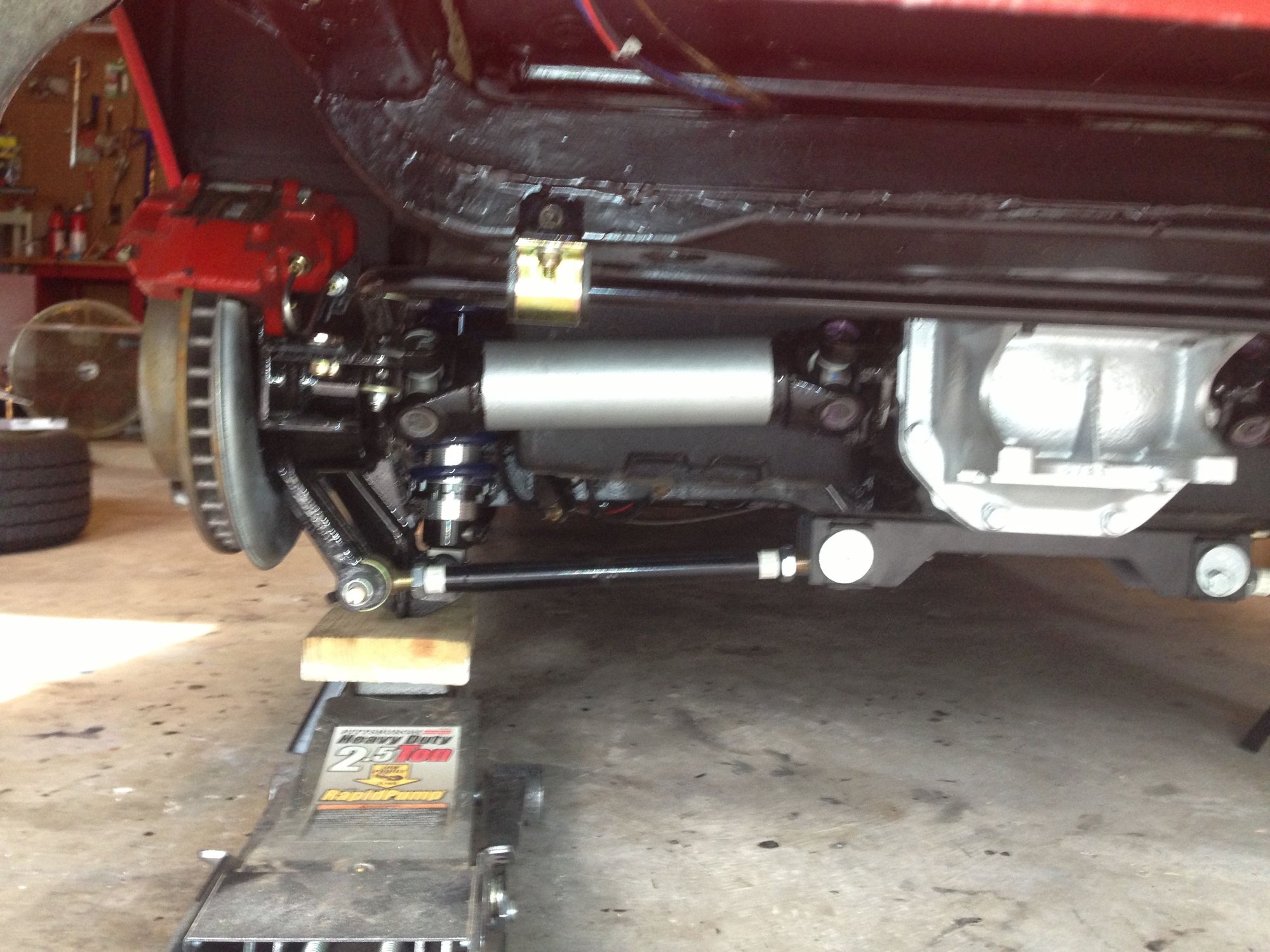

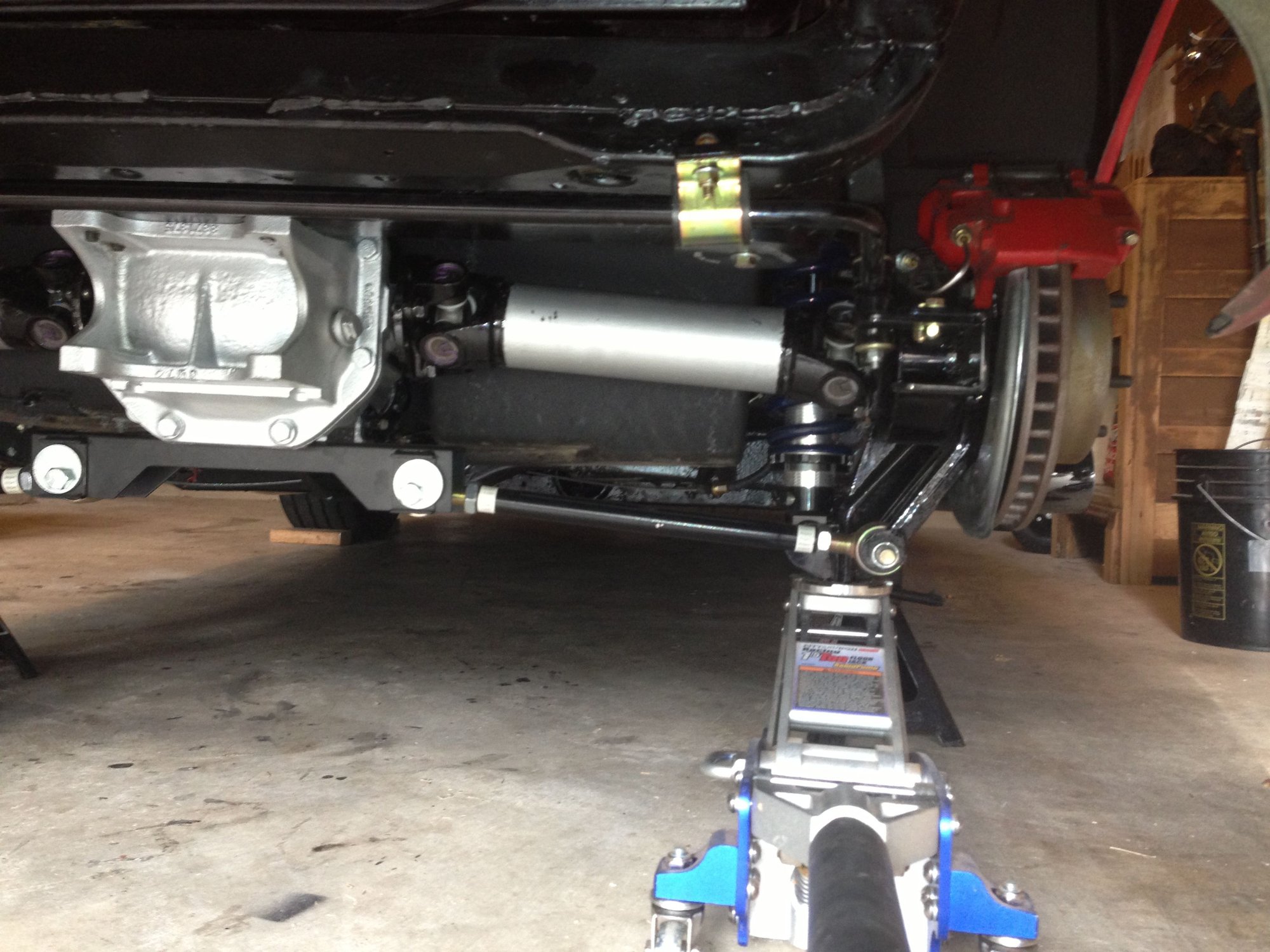

I think you are really going to need to measure this for yourself, as there may be some variation from car to car. The bulge in the tire (section width) and diameter will make a difference (tire rack site has this info). Some people have gone with as much as 5.5" backspace (which is 0 offset on 10" wheel). I couldn't go more than 5.25" BS on a 9.5" wheel (also 0 offset) with my tires 275/18-40 Bridgestone Potenza RE-11. And with that I have 1/4" of clearance with the frame at the TA pocket.
If you go with a smaller tire, I think you may gain a little room. With something close to a stock diameter of ~27", the frame is your limiting factor, so offset trailing arms may not help. They didn't for me.

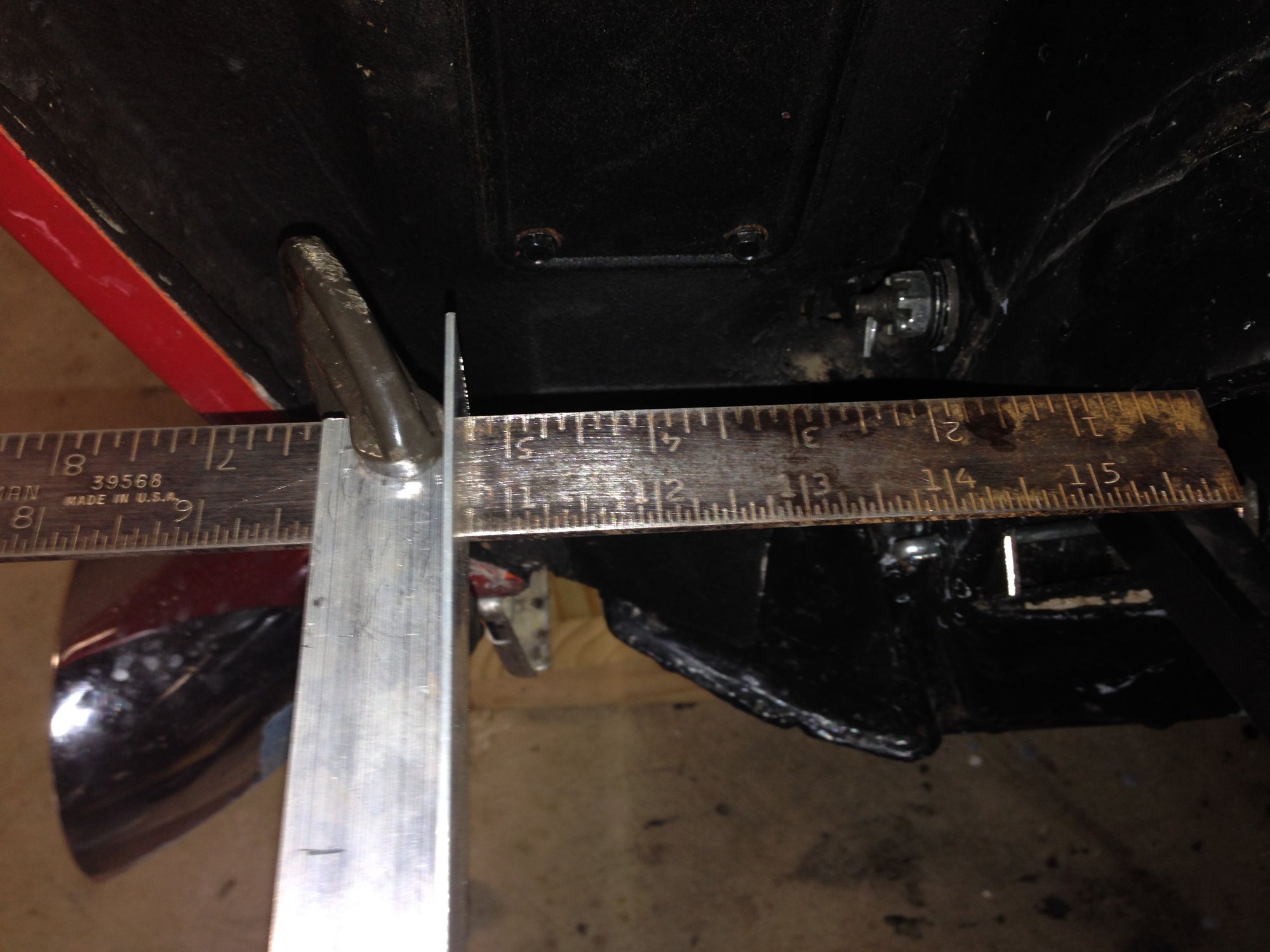

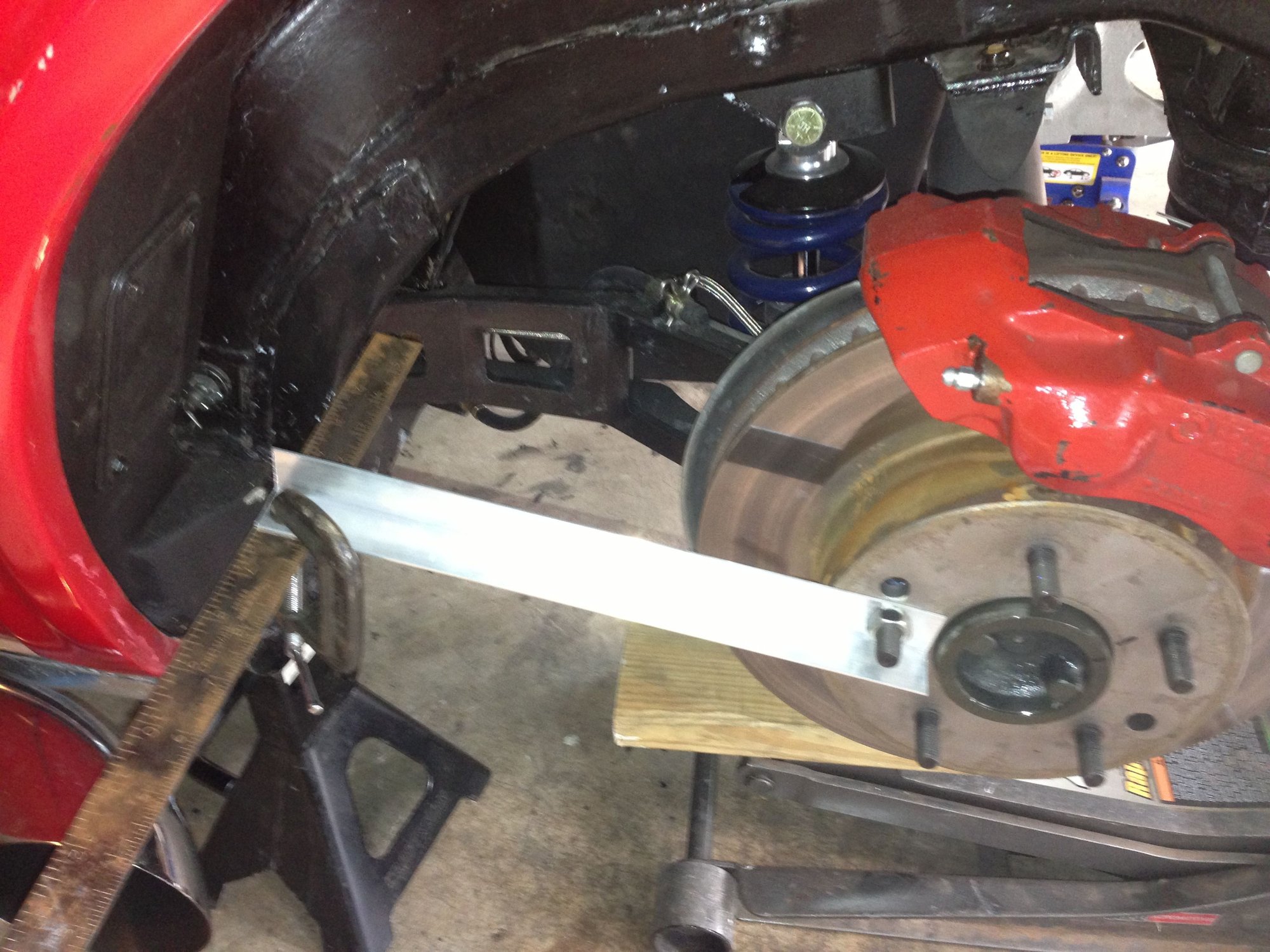

To measure, you need measure the ride height from a fixed point on the body or outside edge of the suspension. Jack the car up with two jacks (I used the shock supports as jack points, but I have Van Steel offset TAs and coilovers...not sure if this is a good idea on stock TAs), remove the wheels, and carefully lower the car to its ride position to ensure the suspension is fully compressed. Then I bolted a piece of angle aluminum to the hub. The metal was cut such that outer edge of the metal was the same radius as the tire I chose. I clamped a ruler to the angle aluminum at a 90* angle. By rotating the hub I could check clearance at all points of the frame, wheel well, and TA.
Here's the set up:
I didn't do this right when I took these pictures. Because the rear end is too high, the suspension isn't fully compressed because weight has shifted forward. With the car on the ground and wheels on, my half shafts are almost perfectly level. I re-did these measurements before ordering $1,800 in wheels and used wood blocks under the rear jack point as a backup to the jack rather the jack stands. I didn't let the car rest on the wood, they were just a safety in case something slipped.
