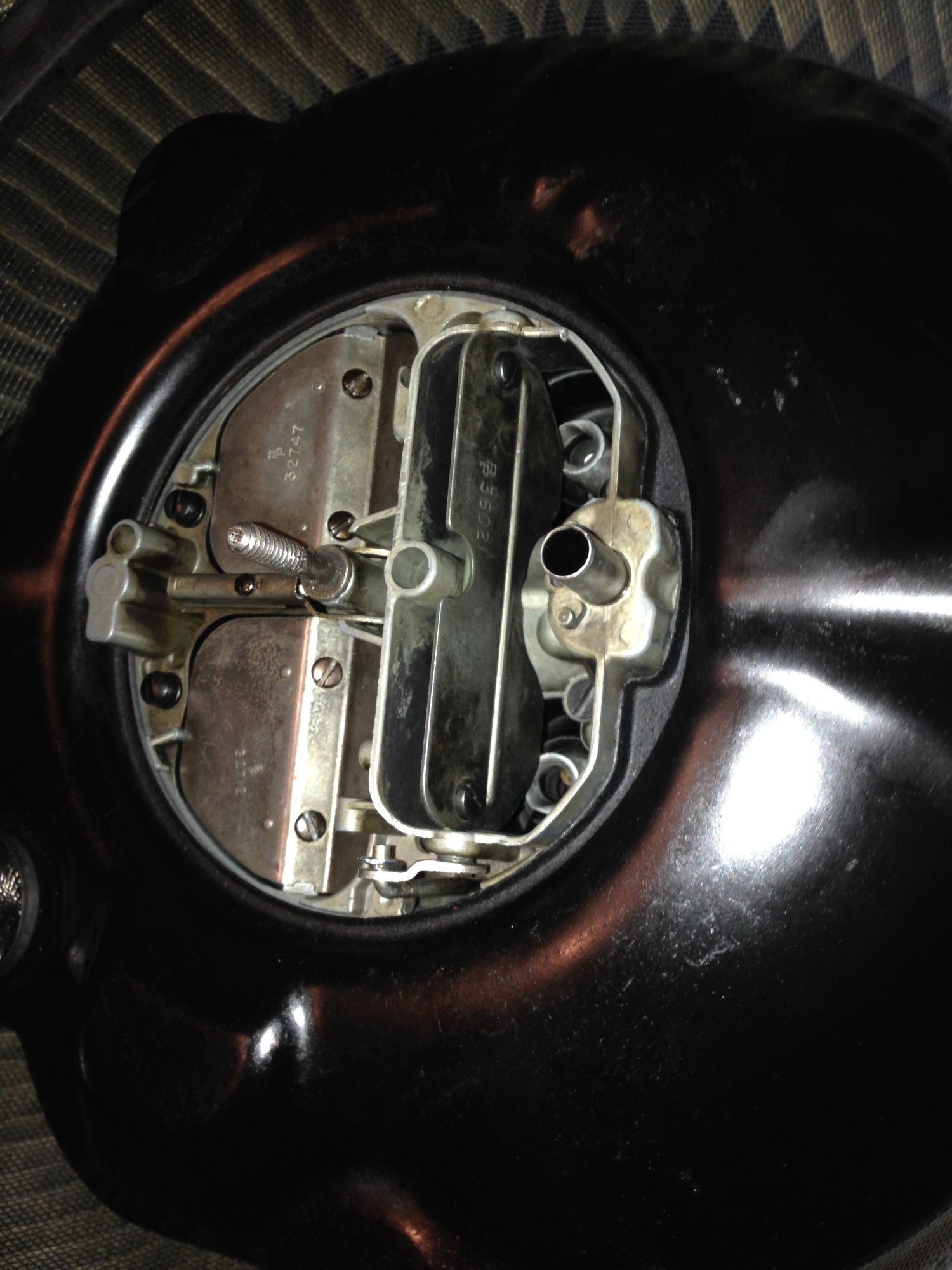

Thank you everyone. Ok I went outside yesterday to try to start it up and document it.
Choke was all the way open before I even got in the car, see above.
I pushed it closed manually with my finger. I had to fight it a little to close 4/5ths of the way.

I suspect your choke is not properly adjusted. Do you have a shop manual? The procedure is easy if you do.
Sometimes when the bimetallic choke is improperly adjusted, it can prevent the choke blade from closing fully. You should have a divorced choke, so first check the position of the coil on the manifold in its little house, then you're looking at bending the choke rod (slightly!) to get the adjustment dialled in.

When I push it closed it's like it's just catching slightly on something on close up.

You need to push the accelerator pedal to the floor once to allow the choke to close.

I guess I wasn't pushing it far to the floor enough. I figured if it opened by temperature, it would close by temperature,,, No?

Accelerator to the floor on a cold engine sets the choke.

After shutting down a warm or hot engine, the choke plate will stay open due to the linkage.
If you put the throttle to the floor once or simply operate the throttle linkage on the carb, the choke plate should snap shut.
You should not need to touch the throttle again to start the engine.
As soon as you start the engine the choke plate will open slightly and then gradually open up as the choke warms up.

The throttle doesn't have to be pushed to the floor to set the choke-a slight touch will rotate the primary shaft enough to allow the choke to close and the fast idle cam to hold the throttle open. With the engine cold, remove the air filter and give the throttle a slight tug and watch what happens.
