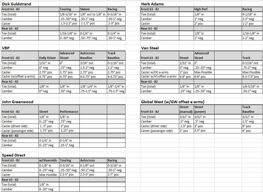

I compiled alignment specs from different sources. Let me know if there are corrections or additions. This might be a handy reference.

Added SpeedDirect

Excellent info. I'm surprised everyone recommends negative camber. T

Correct me if I'm wrong, top in and bottom out = + camber.
Most race cars I see are set that way for road racing. [F1, GT ect.] T
Old Oct 7, 2015 | 08:52 AM
69autoXr's Avatar
69autoXr
Joined: Jan 2004
Posts: 3,245
Likes: 210
From: Detroit MI
No, top in and bottom out = negative camber.

Had mine aligned recently. Had way negative rear camber. Now set at 0 - daily street driver - and it looks weird to see wheels straight up and down, not tilted in at top.

Added Rancho Suspension.

Hi, anyone has a good link showing how to DIY align a C3 1978 (or any C3 model year)? I am especially interested in caster. Thanks.
start here
front end alignment shop needed - CorvetteForum - Chevrolet Corvette Forum Discussion
also google c3 corvette DIY alignment
Old Dec 7, 2020 | 07:06 PM
cagotzmann's Avatar
cagotzmann
Joined: Jun 2011
Posts: 3,114
Likes: 592
Here is My DIY Alignment method to take all measurements. As for what to adjust
Front:
shims in upper control arms : camber / caster
Tie rods sleeves: toe
Rear:
shims control arm bushings: Toe / Thurst angle
camber bolt / adjustable sleeve : Camber
My DIY Alignment method - CorvetteForum - Chevrolet Corvette Forum Discussion

I see in some setups 5° of camber , is that the total camber right and left or each side?
That would be caster 5 degrees each side, and requires adjustable upper control arms (spc) or offset upper control arm shafts, non-factory upper arms to get more than the factory spec of 2.75 degrees.
i know from my own expirience that for 5° caster you will need to reoplace the a arms (i have global west on mine) . But if you check the specs of some of the setups here its says 5° camber and 3° of caster
thats way i asked if its 5° of total camber right and left ...5° of camber of each side its not normal
