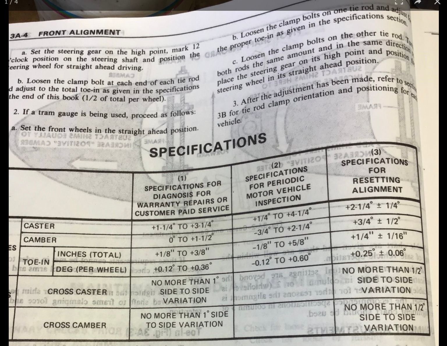

Dont they just need the alignment specifications?
Did you ask if you provide the specifications if they can do it?
Why are you just trying to align the front as opposed to rear also?

And or do it yourself?
https://www.corvetteforum.com/forums...on-please.html
https://www.corvetteforum.com/forums...sing-ipad.html
79 below

They just need the alignment specs. So look them up, decide what you want in the range, then have them do that.
Better yet, find a shop that wants your business to the point that they would suggest what numbers work best.

If you look at the factory specs - the allowable tolerances they give are HUGE !!!!!
You want a shop that will hit the numbers you provide to within about +/- 1/8 degree on Camber and maybe +/- 1/2 degree on Caster. Toe should be accurate to a 1/16".
Now - the question becomes what numbers do you want to use. The factory alignment settings are a starting point - and will work OK if you normally just cruise in the car. If you want the car to handle better, and are willing to trade off a bit of tire wear for better handling - you need to make some changes.
Personally - I like at least 1/2 degree of neg camber (tops of tires closer together than the bottoms of the tires) to aid handling. Add in a bit of toe in (just to avoid getting into a toe out situation) - which tends to make the car "wander", and something like 3 degrees of caster to improve high speed stability. YMMV...

thats what it says..the others were inspection and warranty

Secondly, when it comes to the alignment settings, keep in mind that those numbers that "interpon'' graciously posted, are from a 40 year old, GM shop manual, written for the old fashioned alignment racks that used a light, prism, and optical lens, that projected the light beam to a chart that hung on the wall of the shop. The "technician" took his "best guesstimate" to place the beam of light on that scale, and called it an alignment. Today, the racks are using lasers and targets, with insanely fine increments to set the wheels. Most alignment racks have software that will go back quite a few model years..
