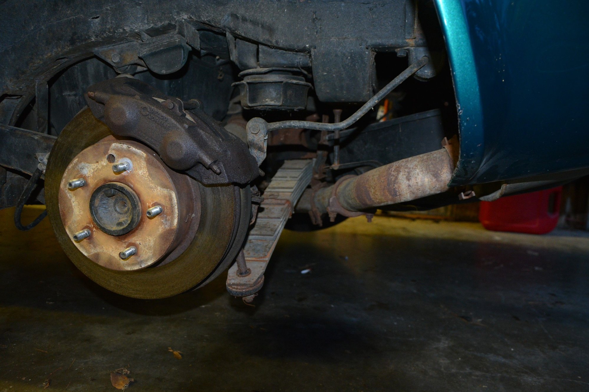

Am I correct that the leaf spring and presence of rear stabilizer bar mean Gymkhana suspension?
While I won't call the ride torturous, it is certainly very firm with extremely little roll when cornering.

A few highlights...All the Gymkhana cars in the late 70's and all C3 SB's with the Gymkhana suspension had a rear 7/16 GM style rear sway bar (not aftermarket bars with the front type endlinks). No rear 7/16 inch sway bar, (like in your picture which is correct for the sport suspension)...no gymkhana suspension. On your 79 (and my 78), if you had the 1 1/8 inch front bar also which was coupled with the 7/16 inch rear bar...definitely a gymkhana car. GM was on the right path with the front bar at 1 1/8 inch which by today's sway bar standard is very common...most C3's have a front bar that is way too small for any type of handling, just as a general statement.
