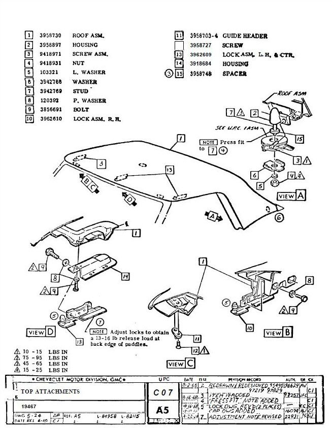

Undo the latches at the headliner then remove the 2 nuts holding it onto the deck. The nuts are located at the corners by the door and are a pain the *** to remove. I've head of some people releasing the latches then pulling the release lever and lifting the hardtop/deck lid in one piece to access the nuts.
Nuts #4 view 'A'

I added some info to the illustration that Jim2527 posted.........
