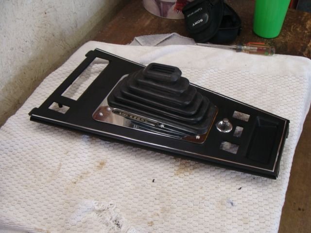

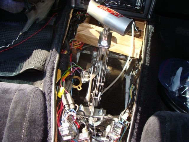

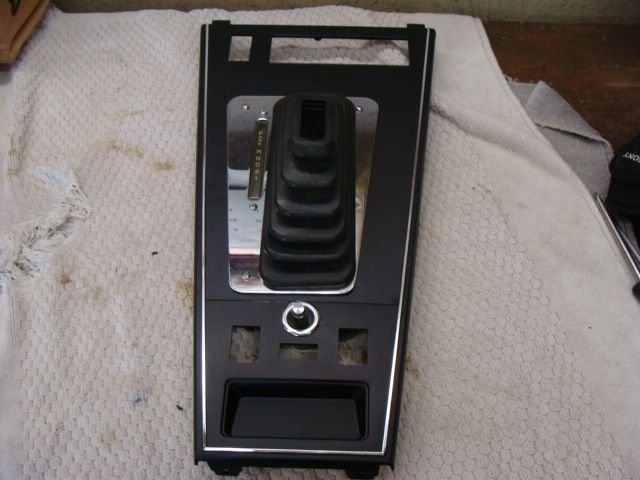

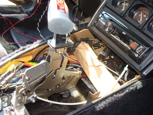

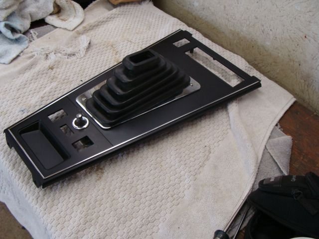

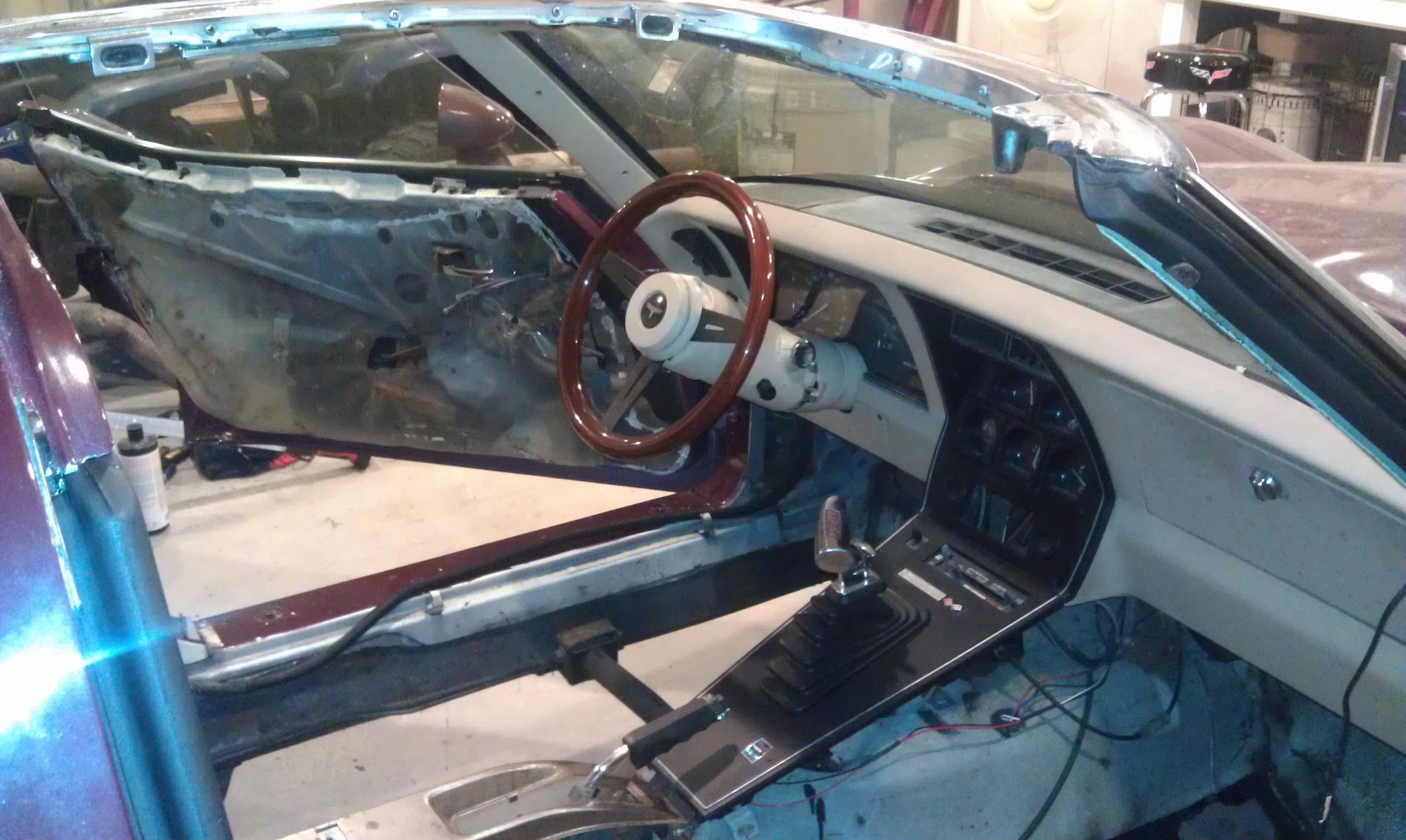

Default B&M shifter installed
I am in the process of putting a B&M Megashifter in my '81. Just finished the console but haven't put it on yet. I used the model for the late 70's to early '80s camaro console. The shifter is in and works great. Too bad I just blew a rear end out speed shifting it.
I will take some pictures and post later today.
SR

Default Pictures of my installation on my '81 - In progress

Originally Posted by Street Rat
That looks quite similar to the 82 console. From the pics it doesn't appear that you had to do mu fabricating (if any?). I guess Im gonna have to take mine apart and have a look at the guts of the shifter installation.
Fred, It took a heck of a lot of fabricating, measuring, grinding, cutting, etc. Unless you are dead set on installing a ratchet shifter (I was), I wouldn't try it. It wasn't that easy for me.

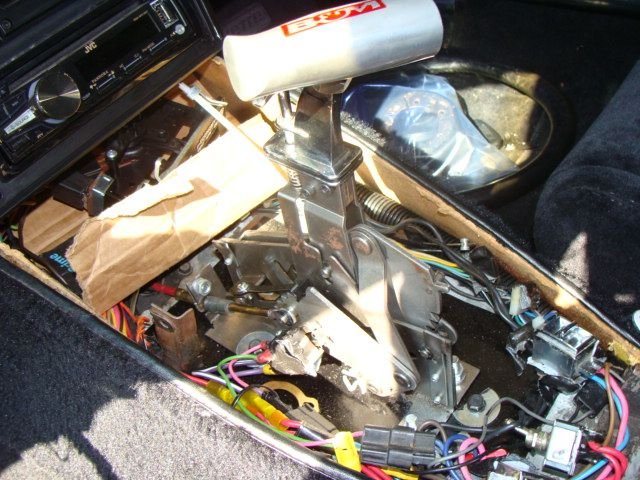

From: Wentzville MO
I installed the B&M quicksilver. Its not a very neat looking under the cover but the shifter works great.
