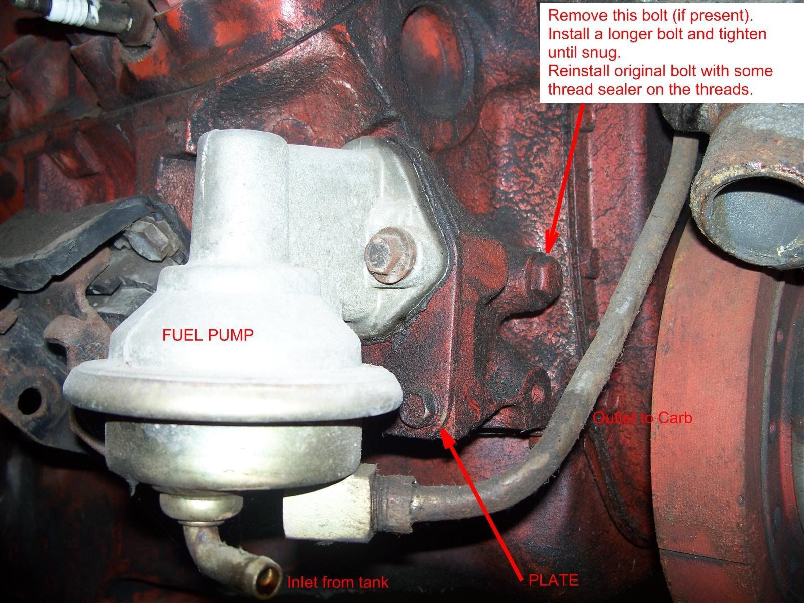

You don't need to take the plate off. 1. rotate the engine so the rod is in as far as it will go.
2.you can just remove the bolt going thru the front of the block that lines up with the pushrod . replace it with a longer one.snug it with rod in the block but don't crank down on it.it will hold long enough to install the pump. just don't forget to remove it and install the shorter one before you crank it.
3. REPEAT: DON'T FORGET TO REMOVE LONGER BOLT AND REPLACE WITH THE SHORTER BOLT BEFORE CRANKING THE ENGINE!!!

Here's a pic.
To 1979: fuel issue question.
