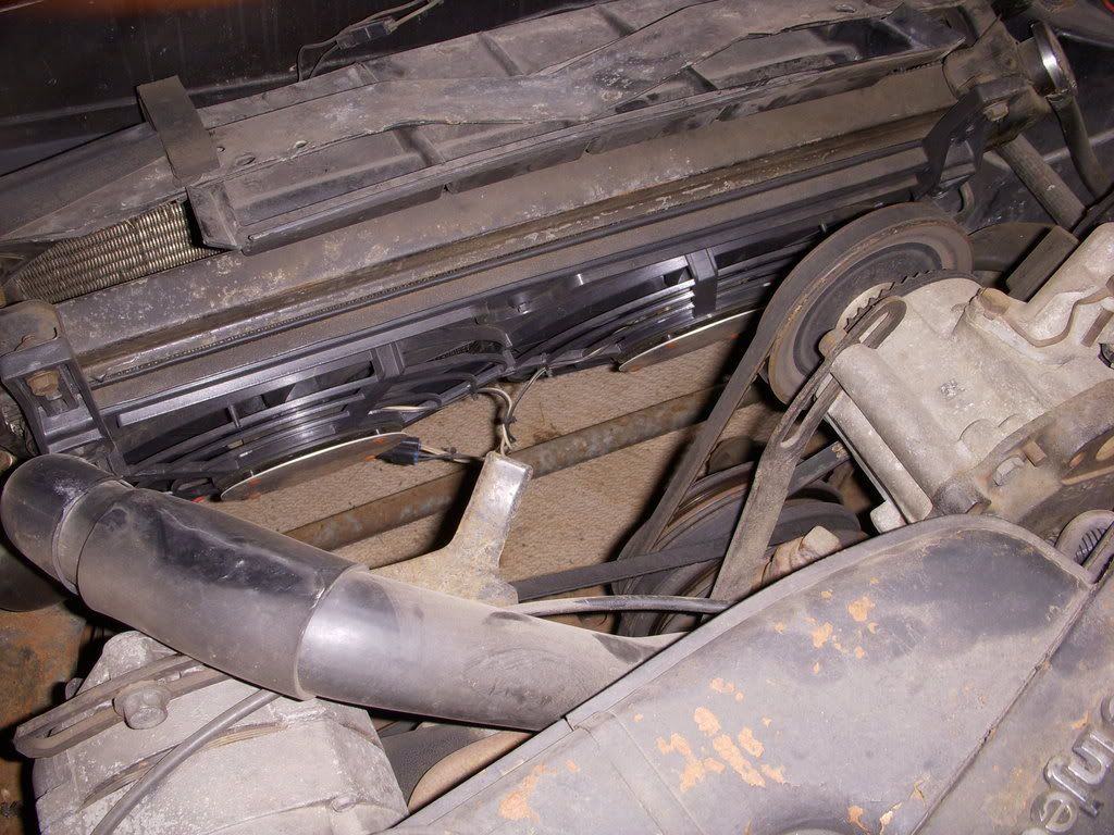

This going to depend on the fans you have.....DeWitts has the Dual Spals, I have a set from him long time now....I drilled holes in the rad support brackets, the tag ends in the rear/back of the radiator, and took some aluminum angle struts from H/Despot and cut out tabs on the ends, to span the backside of the rad......SO to make it possible to fasten the fans in back on the same mounting plane as the radiator, along the bottom some aluminum flashing from home use....is bolted to the fan's lower bolts and tucks under the radiator, making a clean air damn there.....on the top, and sides, I used house plumbing pipe insulation stuffed around sides and top of the fans, it fits pretty good, and holds fine, maybe some RTV to secure it in place across the top.....
My car is a '72 vert with a/c I have '88-91 serp drive so the water pump is not an issue, and I have no comment if it would be IF it was a stock setup.....obviously the stock fan/shroud are toast.....
