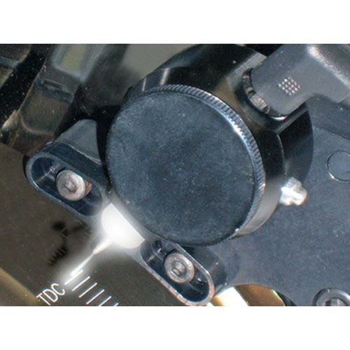

ProForm Instructions
1. Remove your old timing tab, and install your new tab with light.
2. When ready to use, unplug black moisture-seal plug from light module, and plug in the pick-up wire in its place.
3. Attach the other end of the inductive pick-up unit wire by opening the slide on the attaching end, and then placing it over the #1 spark plug wire.
4. Important: make sure all other spark plug wires are positioned as far away from the pick-up unit as possible -- otherwise you may pick up signals from another cylinder.
5. Start engine, and set timing.
6. When finished, shut engine off, unplug pick-up from light module, and replace it with the moistureseal black plug.
7. Disconnect the pick-up from the #1 wire, and store in toolbox or other safe area.

Swiftrider. I like it. Thanks for the pic with the light on. I guess it's time for a new toy.

Cool toy, works if you have the small balancer. Lots of tech for $30!
