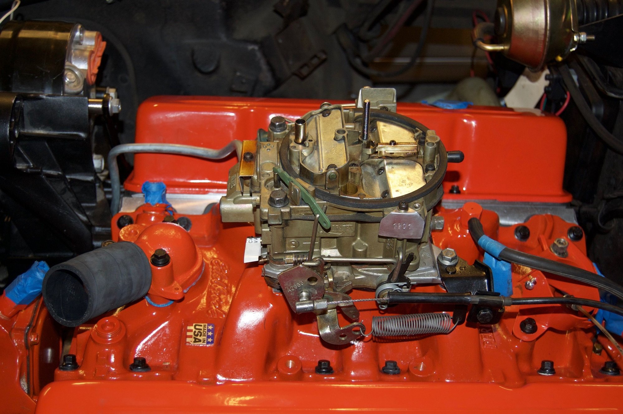

Question about my 71, 350 auto. When I start the vette the smell in the garage is really bad..even on your clothes. The carb is a quadrajet with an Edelbrock tag. Runs great, idles great, starts up on the choke..no problem. It seems to idle to rich. Anyway to get rid of the smell? Will the idle mixture screws cure it? I hate to mess with it because it really runs well. Thanks, Bill

Try adjusting the idle mix. Also make sure your plugs, cap and rotor are good. And points if you have them. It's hard to tell in the pic, but is the choke opening up all the way when it's warmed up?

Choke is opening all the way. Plugs, cap and rotors are new..HEI

The first order of business is to check out the carb choke system and adjust it to work properly. That includes setting the 'fast idle' adjustment PROPERLY.
If set up properly, the choke plate will be almost closed off when you TAP (not stab to the floor) the accel pedal before starting a cold engine. And, once running, the idle speed should be in the 700-800 rpm range (without having to pump the accelerator before starting or constantly exercise it to keep it running). If it is running much higher than that, someone has increased the fast idle to compensate for a misadjusted choke. That would explain the excessive fuel fumes you are experiencing.
Curb idle adjustment screws should only be set when the engine is WARM. They should not be changed to deal with cold-start issues.
Cold start is about 1500. When I stab the throttle it goes down to about 1000. Once warmed up its around 650 700

It really shouldn't be above 700-800 at any time. Yes, when you set the fast idle speed with a warm engine, it is set at 1200 or so. But, when that engine is cold, it won't run at that elevated speed.
Yours is just dumping fuel into the intake when it really isn't needed. You need to set the choke up properly, THEN set the fast idle speed.
When you get the choke set right and the fast idle set right, you won't have all those nasty fuel fumes around you.

If having the exact, factory-specified carb on your engine is not a big deal to you, any Q-jet made prior to 1976 that is in good condition could be made to run just fine on your car. It's just a matter of knowing what to change in that carb to get it well matched for YOUR engine.
The 1901 carb is no exception. As long as it is working well, performance is decent (normal operation AND wot use), and you are getting decent mileage from it, there is really no reason to change the carb out. You just need to set up the choke and fast-idle correctly and you should be 'good to go'.
The complete setup procedure for the carb that came on your engine can be found in the "Engine-Fuel" section of the Chevrolet Chassis Service Manual for your model year. You can likely find that same choke setup procedure on the internet, if you search a bit.

Is there a leak in the hose going to the choke pull-off? If not, I would recommend vacuum testing the pull-off.
