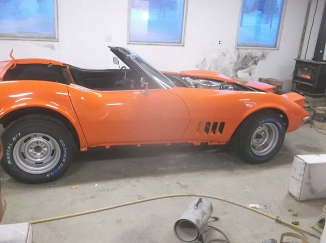

I was a little worried at first too - being the body was off the frame for a little over 30 years. Once together, it took a few weeks after painting and filling with fuel to settle in. My tires are P225-70-15 they fill the wheel well fine.

If mine turns out half as good as yours I'll be happy....
