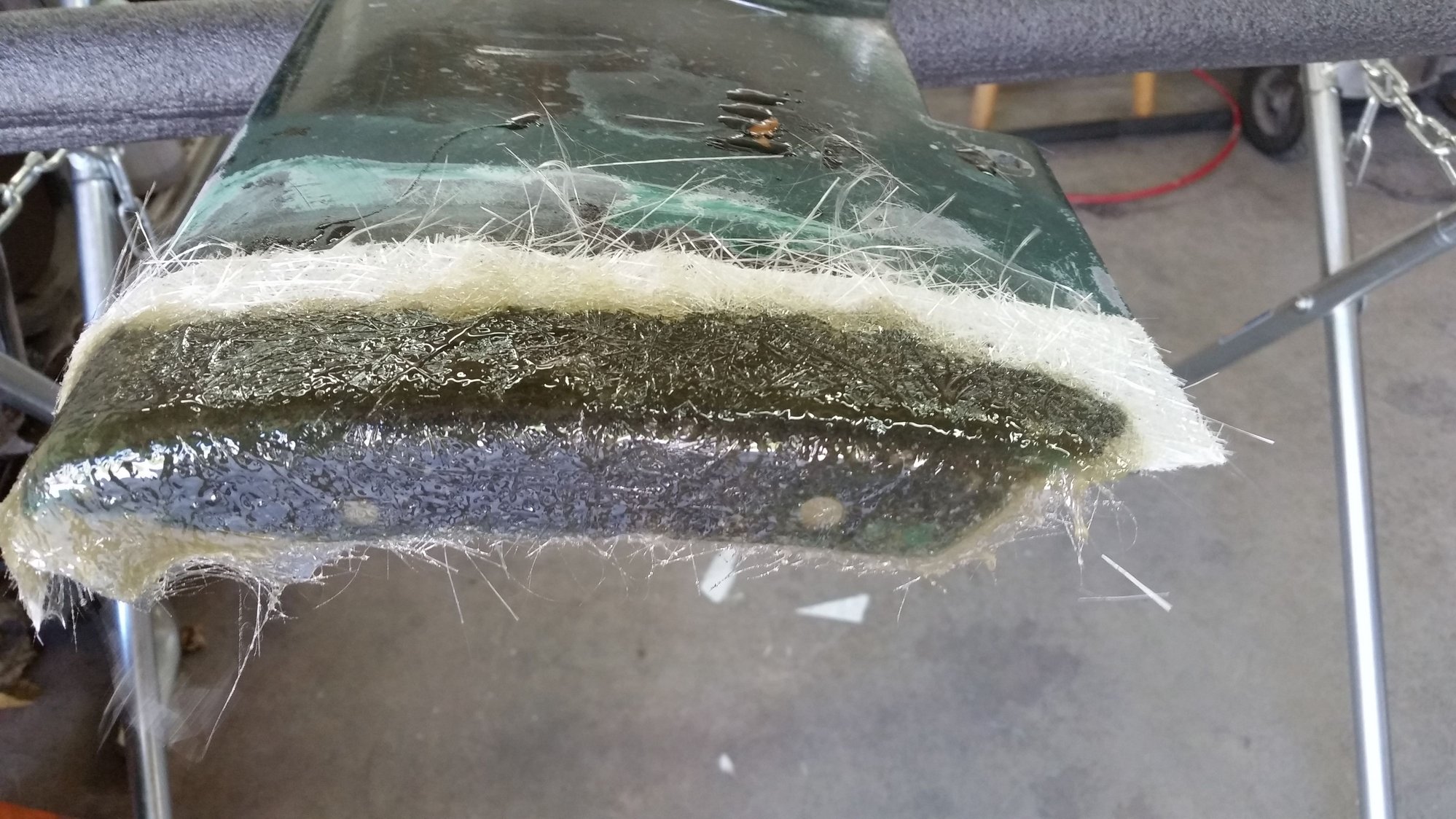

Well like Alan mentioned there are a number of ways but I will add 1 more. I purchased a side exhaust panel on the forum. Removed all the paint. Laminated the ends of the valance to make a mold. Then I reversed the sides to obtain the attaching flanges and then used VPA to fill in the remaining part of the under exhaust.
ZIO

That looks good too...I guess I've got some figuring to do....
