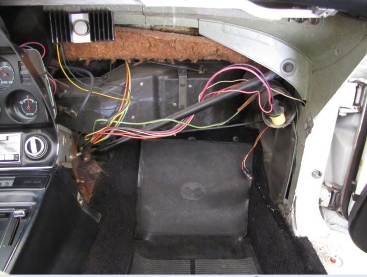

Well, the basic steps are to disassemble your passenger side dash until you get to this point:

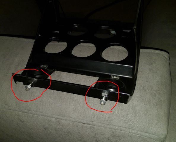

Once you get here your ready to attack the center console. It is very fragile so be careful. You'll need to be sure to unscrew the nuts at the bottom of the console. They are very difficult to get at. This is where you'll probably remember the pain from 25 years ago. If your lucky you didn't put them back on very tight.
Once the these nuts are off you can remove the radio nuts and tip the center console forward to slide out the radio to the side.
Good luck.
Good luck.
John
Everything was as you described (including the pain) except those bottom screws and nuts were missing. I don't remember them from the first go-around, either. The radio is out. Now, to find a shop to send it to. That'll be my next thread.
