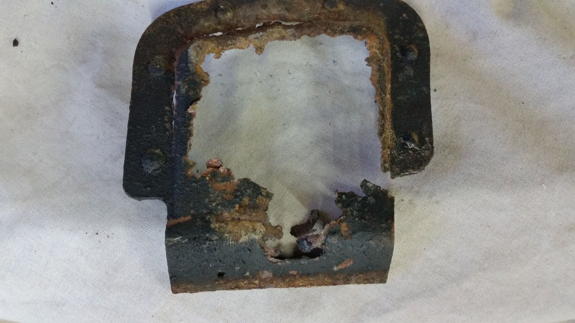

While you are under the car check the seat belt brackets and make sure they are still there in good shape. No sense in having new belts attached to rusted out support brackets.
ZIO
Check all of those supports you are the one in the seat. Also you can take a look at the #4 body mount cup just to get a feel for how much of this car is in good shape.
