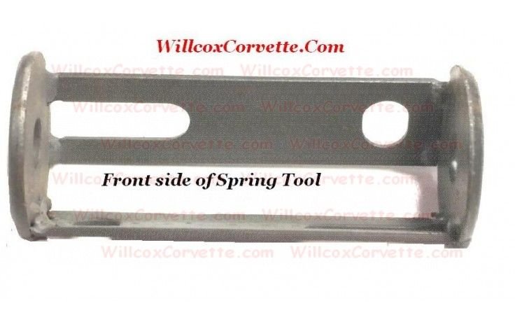

I made this years ago... If the tower is not out of the car.. this is the best and easiest way to install the spring. (it takes about 1 minute).
What you do is close the deck lid, slide this in place and then raise the deck lid.. the spring stays extended... While the work is being performed we leave the springs in the retainers.. Then when we go back we slightly close the deck lid, install spring and then open the deck lid to expand the spring and release the tool...
So.. the trick for going in without taking it out and leaving it.. I have a table mounted cherry picker and I hook one end of the spring in the table and the other end on the hook.. I raise the arm to expand the spring and then install the tool. You'd have to get creative on how to load this tool...
This tool consist of two old trailing arm shims... two end spring bolt washers... Now I put a bend in my shims but you wouldn't need to do that and I doubt you'd have a press strong enough to bend that shim... Heat would work though... The washers sit on top of the shims and are welded.... they make a perfect spaced tool for the spring removal.
And for those that don't want to make one, we now sell them. https://willcoxcorvette.com/decklid-...ing-tool-63-75

That is basically the same tool Chevy used to issue for removing hood hinge springs on the rest of their cars. Unfortunately, I believe the issue here is installing an unstretched spring onto the hinge.
Yeppers... That's where I got the idea....
Figuring out how to stretch the spring is the issue. I have the table hoist that makes it easy for me... That's where one would need to be creative. Ideas that come to my mind... a floor jack possibly, scissor jack, wench on a trailer, old bumper jack, other suggestions?

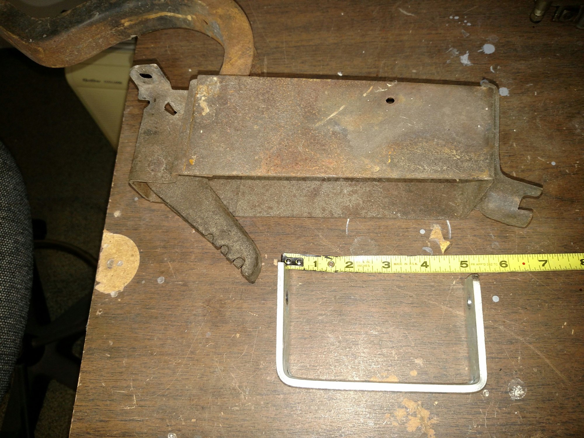

Thanks Willcox, after reviewing your fixture, I made 1 from plate steel just by bending, job done thank you !

great ideals, I bent a steel bar app. 5" and pulled the spring to extend and inserted the fixture, put them in place pulled the hinge to release pressure and removed fixture, done.
Knowledge is a wonderful thing ! thanks,
