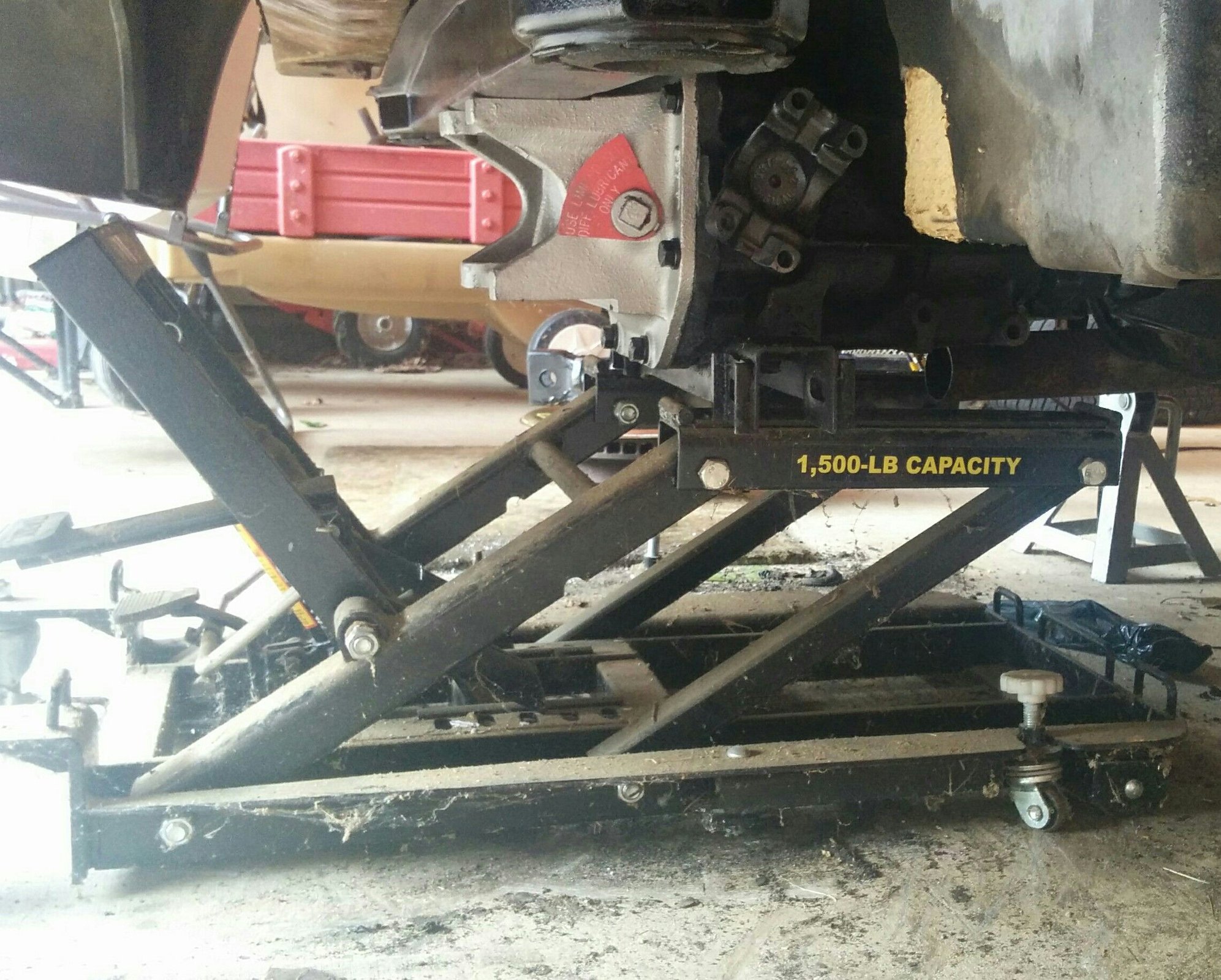

I happened to have a picture in my phone from when I used my motorcycle jack to mount the rear diff / cross member.

I happen to have a harbor freight low lift transmission jack, which made removing and reinstalling the diff a breeze on my '79. It was around $80 with a 20% coupon and I've been surprised at all the different uses I have found for it.

FWIW, the trans jack I have isn't hydraulic. You snap a 1/2 drive ratchet to it and crank it up and down. No chance of sudden collapse unless there is a structural failure. It's a pretty simple design.
Not to say everything you said isn't true, but this thing seems pretty good.

Originally Posted by 454Luvr
Yep, that's what I would want - a scissors mechanism. Thanks for mentioning that.
Yes that's what it is:
