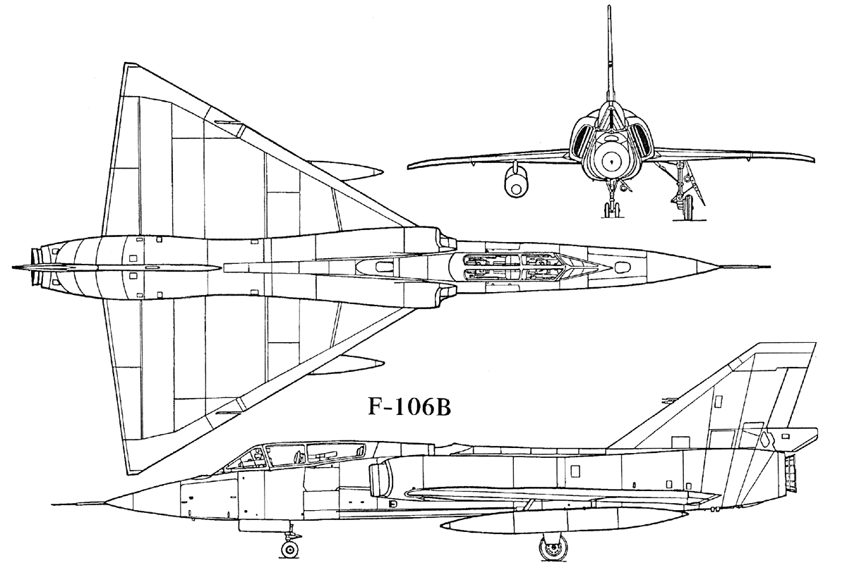

This is correct. Having worked in Aerospace for over 25 years, I can tell you, that it has been used in a variety of aircraft designs, and was called 'the coke bottle shape' informally, because the fuselage would have a narrow waist about its mid-point.
The whole reason a venturi works so well, is because either internally (like your carb) or externally (like your F-106 Delta Dart), is that the same volume of air, going through a narrower profile, has to speed up, relative to the larger profile it started with. That increase in velocity, with a small opening, will create a vacuum and pull the fuel out of either the primary or/and the secondary and the shearing effect as it leaves the passage, across a sharp edge, atomizes it.
The F-106 benefited greatly from the 'coke bottle' design and this feature made it even faster, then it's predecessor, the F-102.
F-106 (coke bottle or venturi waist)
F-102 (no coke bottle, slower predecessor).

Originally Posted by F22
...that it has been used in a variety of aircraft designs, and was called 'the coke bottle shape' informally, because the fuselage would have a narrow waist about its mid-point.
This sounds like you are describing the "area rule"
